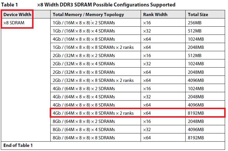

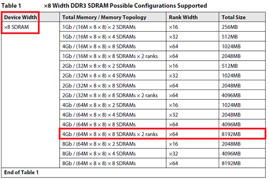

I encountered K2H DDR3A read error in our custom target board.
I have a question.
Question)
- Do DDR3A address pins have a sufficient drive strength to drive 8 or 16 DDR3 SDRAM?
(Especially, we are interested in the drive performance when multi address lines are changed simultaneously.)
- Can I change the drive strength of DDR3A Address/Data line?
Our trouble)
We are using following DDR3 memory under DDR3A:
DDR3 memory : 4Gb (x8b width) x8 devices = 4GByte
1600 data rate .. the issue happens
800 data rate .. the issue does not happen
We have monitored DDR3A_CK+/- and DDR3A_Ax.
Actually, we can observed blunt wave signal in DDR3A_Ax.
