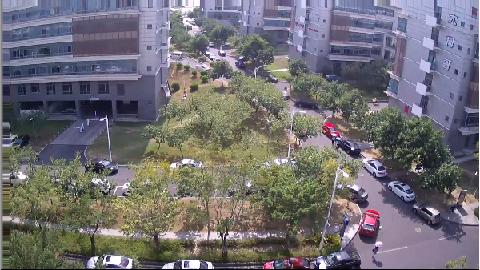

  • Since I can't use scalar link, now I use DEI link to scale down the video instead in the usecase of last post. The links chain works but the output stream has some problem. The top and left of the video is not correct as shown above. I want to know the reason and which parameter should be modified?
    If I remove DEI and nsf link, i.e., the ouput of decode link is connected to encode link directly, the video becomes correct.
