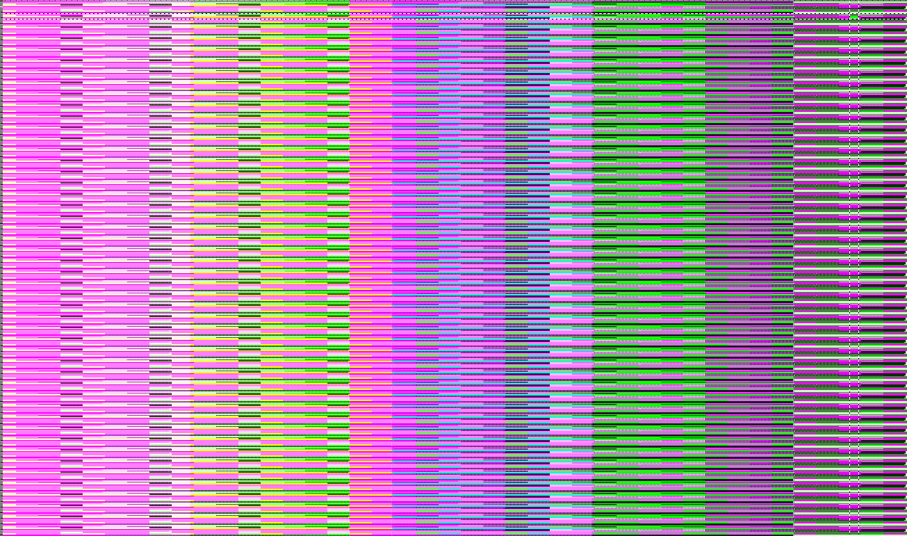

I'm currently working with a DM8127 based system. It uses the ISS to capture a 3MP (2048x1536) image from a sensor at 30 frames per second. This image is then passed through both resizers in the ISS (RSZA and RSZB). The plan is that the image should be rotated using tiled memory.
The software that is being used is TI EZSDK along with ISS code version 3.5.
The BTE has been enabled in the ISS module and extra code has been added to enable two new BTE contexts to handle RSZB memory accesses (four contexts in total).
If an image is captured from both resizers I am finding that the image using the contexts for RSZA is ok, but the image using the contexts for RSZB is corrupt. The problem seems to be related to the context start addresses used for the contexts. If I swap the context start addresses around (that is make the contexts for RSZA use the context start addresses for RSZB and the contexts for RSZA using the context start addresses for RSZB) then the corruption moves from RSZA to RSZB, so it looks like there is something incorrect with the context start addresses.
The start addresses used for the contexts are as follows:
RSZA - context 1 start address = 0x000
RSZA - context 2 start address = 0x800
RSZB - context 1 start address = 0x4000
RSZB - context 2 start address = 0x8000
Below is a register dump of the BTE registers showing a typical set up. Currently, just for debugging purposes, I am not resizing either stream, so both streams are being captured at 2048x1536@30fps.

I have also attached a screenshot showing what the corrupted image looks like. This image should be a standard non-rotated colour bar pattern.
I would like to know if there is any obvious problem with the way that I have configured the BTE contexts?
The BTE contexts use a virtual address for performing address translation. Can this virtual address space be shared with the tiler virtual address space (0x60000000) on our platform?
