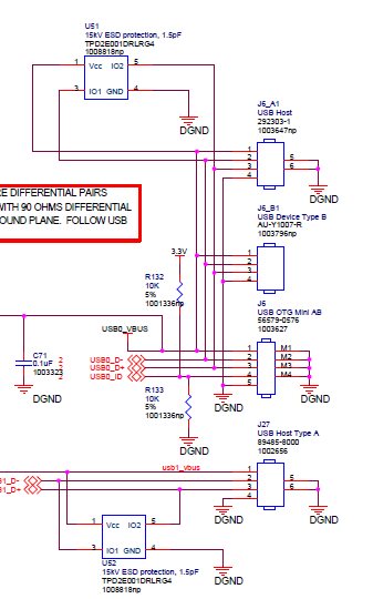

The problem of use the uvc usb camera on OMAP_L138 EVM.
Other Parts Discussed in Thread: OMAPL138
    Now I use the uvc usb camera as capture device and connect to OMAP_L138 usb port.
    First I add the uvc driver chice  when make menuconfig and when load the kernel I use the v4l2 demo to capture and save a figure,but it is stopped  at the ioctl command of VIDIOC_STREAMON .
   The follws is my log sessions and the v4l2 capture demo,could you help me find the mistake I made or could you tell me that Does the OMAPL138 support the uvc usb camera .

  • Hi Ouyang,
    Do you have any USB devices on this USB port and any USB HUB is present ?
  • Hi Titusrathinaraj,
            My board is LOGICPD OMAP_L138 ,it has two usb port I use the J27 is Host Type A usb port , and another is J6 USB OTG Mini AB.
           I Found a problem In the follow log  usb 2-1: not running at top speed; connect to a high speed hub
    Is that i should connect the usb camera to another high speed usb port .
           Thanks very much.
    Ouyang,
         My usb camera is A type interface and connect to LOGIC PD OMAPL138 J27 usb interface,I donot use any usb device and usb hub . Is that true the host usb type(J27) is usb1.0 and the OTG usb interface(J6) is USB2.0 on L138 board?
        Thanks very much for you help.
    Ouyang.
  • Hi Ouyang,
    Yes, J6 is USB OTG port and J27 is USB1.1 port.
    Have you tried any other USB webcam ?
       Thanks for you reply ,I now have two usb camera ,another is a gpsca usb camera which is sn9c120 it connect to J27 can work fine.But i don not have another uvc camera.
        Thanks very much.
    Ouyang.
  • Hi Ouyang,
    Compare the both cameras in spec.
    Are you facing issues when you connect camera in USB2.0 port ?
    Have you tried to connect GPSCA camera in J6 port is USB2.o port ?
          Today ,I excute test demo when I connect the uvc camera to USB2.0 port .it doesn't have the follow log information :not running at top speed; connect to a high speed hub.But it stopped at VIDIOC_STREAMON command ,the log is
          uvcvideo: Failed to submit URB 0 (-90).
          VIDIOC_STREAMON error 90, Message too long
          I don't try use GPSCA camera in J6 port is USB2.o port because the camera is USB A type ,it  cannot connect to J6 port.
