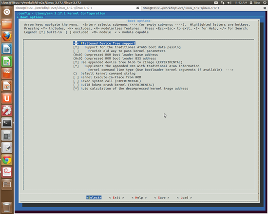

  • Dear Titus,
    many thanks.
    I am on the right path to solve the issues i have. I have a last question.
    What is the proper way to boot without DT blobs ? I couldn't find detailed info for this, so i added a small hack to set machine type and skip dt blob check.
    Seems i cannot disable DT blob check in menuconfig, FDT is forced selected:
        -*- Flattened Device Tree support
          [*]   Support for the traditional ATAGS boot data passing
    Many thanks
    angelo
  • Hi Angelo,
    I'm in out of office now.
    I will send you the .config and steps tomorrow for that.
    Check the "depends" options for DT support in menuconfig.
    Also check the "help" messages in menuconfig for "Flattened device tree support"

    I'm also enabled the same device tree options for OMAPL138 LCDK board and never faced any boot issues and we can't disable since it is selected by all the architecture (Ex: Davinci, OMAP etc).
    It will get selected automatically when you enable "ARCH" type and can't disable it.
    If you want to disable, you can remove the "DAVINCI" arch name from the list in option "Selected by"
