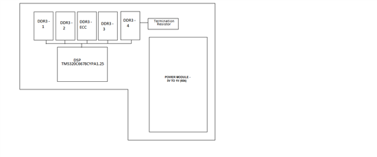

Dear All,
Our Design Engineers has completed there Placement for QUAD DSP Board. I want certain clarification before Manufacturing the board.
Due to Area Constrains our placement engineers has placed the Power Module Near the DSP & DDR3 Chip.
Due to this there can be any issues in accessing the DDR3 through DSP.
I have attached the Image For reference.
Can any one provide there suggestions. As we re running out of time for Manufacturing.
Thanks in Advance.
Avinash N
  • Avinash,
    It depends on your power supply and power and ground plane layouts.  Noise can couple into the DDR3 circuitry if not managed properly.  Be sure to arrange the power supply components such that the large AC ripple currents (including those in the ground connections) remain isolated to the top layer.  Be sure to have adequate decoupling.  You may need to perform a Power Integrity analysis to be certain you have chosen proper capacitors and placement.  DDR3 power planes and routing must be isolated from noise sources.  That is the purpose of the keep-out guidelines.
