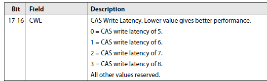

when looking at the DDR3 controller SDCFG register it looks like there's an error in the documentation regarding the CWL [17:16] and the SDRAM_DRIVE [19:18] fields. The CWL field is 2 bits wide, yet values that require up to 3 bits can be written.
The error is also present in the DDR3 Register Calc v4 spreadsheet and the GEL files.
Can I assume that the CWL field should be [18:16] and SDRAM_DRIVE should be [19]?
