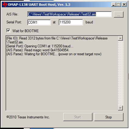

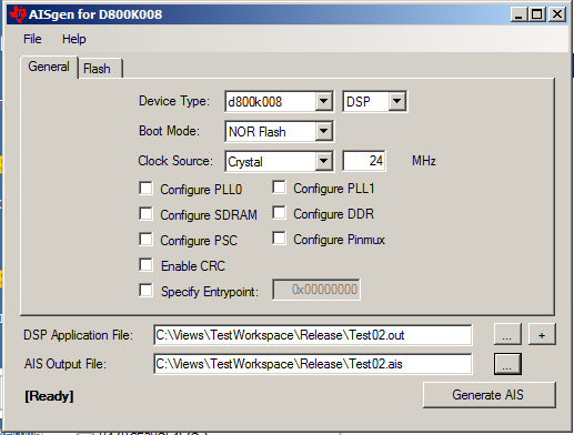

I have run AISgen_d800K008.exe and used it to generate an ais file from a simple .out file.

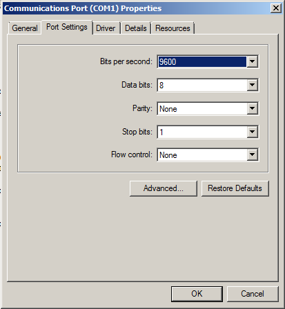

When i run UartHost.exe and attempt to write the file it stops at Waiting for BOOTME.. and wont load. I have pressed the reset button on the device and cycled power.

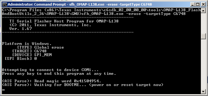

I have also tried using the sfh_OMAP-L138.exe to erase the flash and also hang at waiting for BOOTME.
Pins 7 and 8 on S7 are on.
