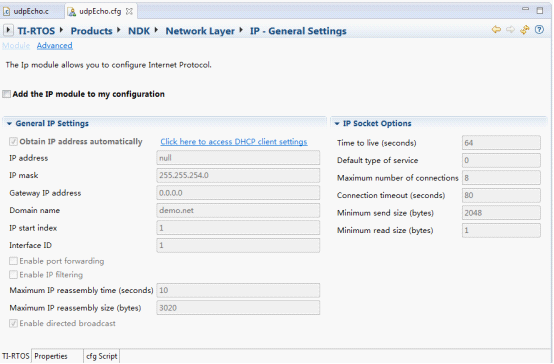

    I modify the content udpEcho.c as follows:
     *    ======== udpEcho.c ========

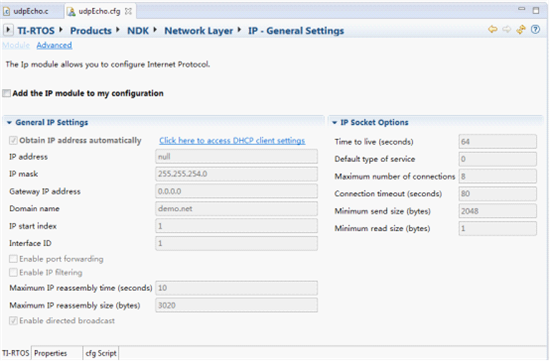

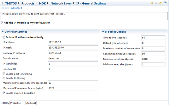

    I put inside the IP module configuration .cfg modified as follows.After modifying the conflict phenomenon no code before, but found the communication function can not communicate, can not connect. May I ask what is the code I have a problem or add other problems?
    My ultimate goal is to use C code to replace the configuration in the figure below IP module。
