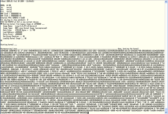

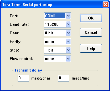

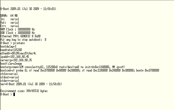

I am using omap l138 evm development kit, and I encountered a problem while booting linux. I am following "quick start guide" instructions, but instead of being able to log in as a root to linux i receive lots of strange symbols and tera term stops responding. Is there any solution to this problem? I attach few screenshots, so you can see what i get in my tera term.
