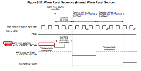

AM335x Warm Reset Sequence.
I think there are many discussion about the Warm Reset(nRESETOUT).
And I am sorry to ask the similar question.
I would like to know if the "Figure 8-22" in TRM(SPRUH73K) will be corrected in future?
Figure 8-22 mentions about "Internal Warm Reset Source" but the figure
still mentions "External warm reset assertion detected on the nRESETIN_OUT pin"
and the "nRESETIN_OUT pin" should be "Tri-stated" before the warm reset
but the figure shows it as HIGH....
