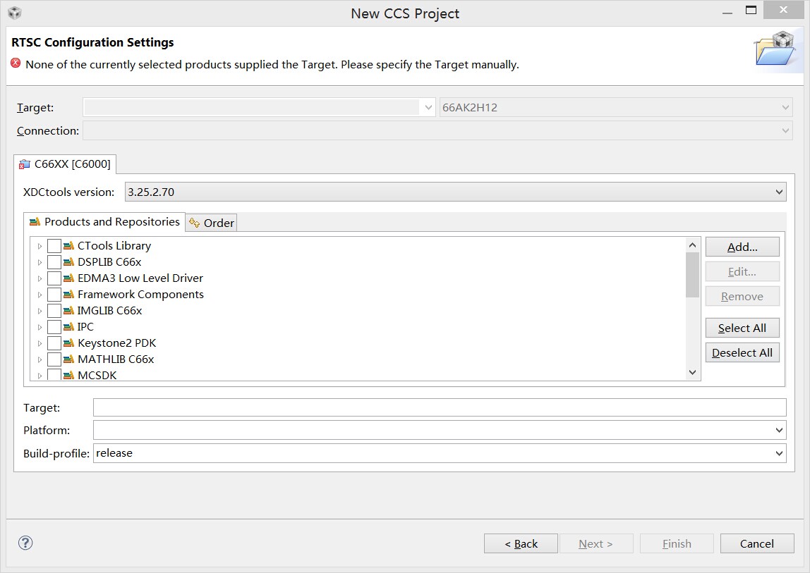

Hi, experts:
    hardware:66ak2h12
    software:CCS6.0, XDCtools version 3.25.2.70
    I want to create a new bios project base on 66ak2h12 and ccs6. when set the second step, there is a issue, the picture as below:
prompt:None of the currently selected products supplied the Target. Please specify the Target manually.
but when I import the TI project  "client_evmk2h", found this projet also use XDCtools version 3.25.2.70, but it can found the target and platform, respective called "ti.targets.elf.C66c" and "ti.platforms.evmTCI6636K2H".
can you give some hints? Thank you
If I selected XDCtools version 3.23.4.60. it had Target called ti.targets.elf.C66c, but there is no ti.platforms.evmTCI6636K2H option in the Platform's drop-down box, only had about keystone I evm option.
    Best Regards
         Gavin
  • Hi Gavin,
    I have requested TI-RTOS member for assistance. Thank you for your patience.
  • Gavin,
    the targets and platforms can be found in SYS/BIOS or TI-RTOS. I can't see the whole list of products that you installed, but I am guessing TI-RTOS or SYS/BIOS are somewhere down the list. Please select one of them and keep using XDCtools 3.25.2.70.
    Targets and platforms used to be in XDCtools, and that's why a target and a platform are found when using XDCtools 3.23.4.60. But that version of XDCtools is old, and doesn't have the newest platforms.
