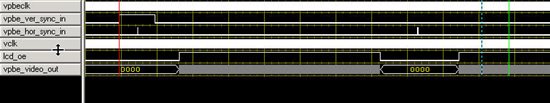

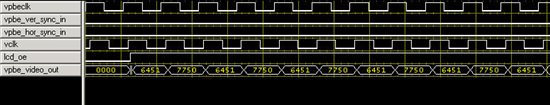

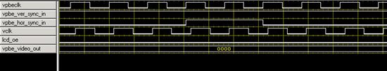

I want to operate the VPBE in slave mode with external clocking. The clocks and synchronization come from a FPGA.
After changing the registers of VPBE what I see on the logic is VSYNC and HSYNC are correct; output clock is ok; LCD_OE ok. The only problem is with the data that is not correct. I send to output a fix pattern but receive different data, also which change from frame to frame.

  • HSYNC/VSYNC are perfectly aligned to rising edge of VCLK. Jitter is no more than 200ps. Please find attached Logic Analyzer screenshots.
    VCLK rate at the moment is 12.5MHz, frame size is 720x576, positive polarity.Received frames are at expected size.
