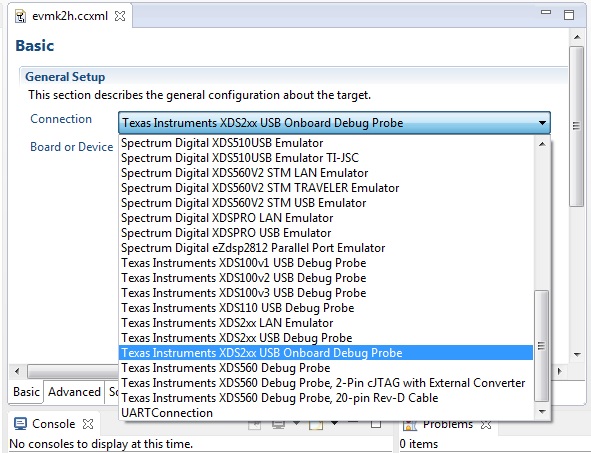

1) How do the dip switched need to be set?
2) which probe do i need to selct: XDS2xx USB Debug Probe or XDS2xx Onboard USB Debug Probe?

    Ans2: EVM K2H have XDS200mezzanine card, you need to select "Texas Intruments XDS2xx USB Onboard Emulator". For more information refer EVM Technical ReferenceDocument

  • Hi Ganapathi,
    i used 0010 as dip setting, i have REV40 on a sticker and A104-1 on my board.
    The option "Texas Intruments XDS2xx USB Onboard Emulator" doe snot exist, i guess you meant "Texas Intruments XDS2xx USB Onboard Debug Probe"
    Still it does not connect:

    Please tyr to using true USB 2.0 ports instead of USB 3 ports on the host. I have attached the K2H target configuration screen shot for your reference.
    i used USB 2.0 all the time. Out of a sudden it works now, i do not know what i have changed. At least i can connect now.

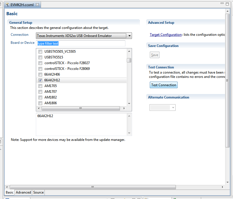

  • HI. I am trying to get started with EVMK2H. I ran into similar problems.
    Problem 1:
    The XDS2XX usb onboard Emulator option is missing from the dropdown menu. I am sure im using usb2. I have the free licensed version of CCS 6.0.1.  I wonder if I need the regular licensed verision to be able use the onboard emulator?
    Problem 2:
    error occurs when i tried to compile and debug a simple helloworld project using XDS2XX usb onboard Debug Probe

  • I was trying to compile a helloworld project for the ARMs
    Have you installed the latest MCSDK package? If no, Please download the latest MCSDK 3.x for Keystone II devices(K2H, K2K, K2L & K2E) and the follow user guide from here.
    Have you installed the Keystone2 emulation pack (ti_emupack_keystone2_setup_1.1.1.0?
  • Better to use latest CCS version Code Composer Studio 6.1.0
  • I  tried and installed CCS 6.1.0. It recognized the MCSDK and the emulation pack. I aslo verified the versions are correct. And the "xds 2x USB Onboard Emulator" is  still missing. Again, I am not using the official licensed CCS. Do I need to get my CCS licensed before I can use the onboard emulator?
    CCS license is not required for onboard emulator selection. You are not able to see the "Texas Instruments XDS2xx USB Onboard Debug Probe" emulator on your target configuration file. Please see my below image:
  • I am able to see "XDS2xx USB onboard Debug Probe" , but I wasn't able to "XDS2xx USB onboard Debug emulator". Sorry, I am new to developing for TI products. I am not sure what is the difference between those two.
