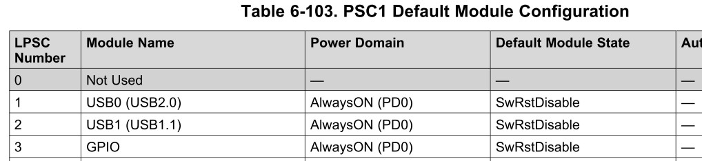

1. PSC1_3 enbale
PSC1_lPSC_enable(0, 3); //GPIO

PSC1_3 --> control GPIO
