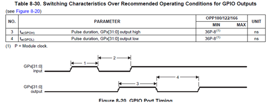

        I need  make a wave to flash the FPGA with GPIO.  I use the IPNC kernel, but the GPIO  frequency is as slowly as 25Khz.I do not know why. It make me use a long time to start  .The max gpio frequency is 2Mhz  in the datasheet.
But how can I improve the gpio frequency ? Whether GPIO have another PLL source.?The sysclk6 is the only one that I just see. And i can not find anything about sysclk6 divider in the datasheet。 My PLL config is below。

  • Hi Antimax,
    The DM814x GPIO module has two input clock signals:
    1. sysclk6 which is the functional and interface clock. By default (at OPP100) its frequency is 100MHz, and can be increased to 110MHz (at OPP120/166).
    2. sysclk18 is the debounce clock, its frequency is fixed (can not be changed) to 32.768KHz.
    Refer to the below wiki page:
    http://processors.wiki.ti.com/index.php/TI81XX_PSP_PM_CLOCK_FRAMEWORK_User_Guide
    root@dm814x-evm:/sys/kernel/debug/clock/osc0_clkin_ck/l3_dpll_clkin_ck/l3_dpll_ck/sysclk4_ck/sysclk6_ck/gpio1_ick# cat rate
    100000000
    root@dm814x-evm:/sys/kernel/debug/clock/rtc_divider_ck/audio_prcm_clkin_ck/sysclk18_ck/gpio1_dbck# cat rate
    32768
