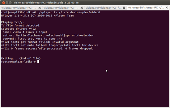

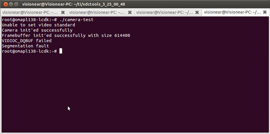

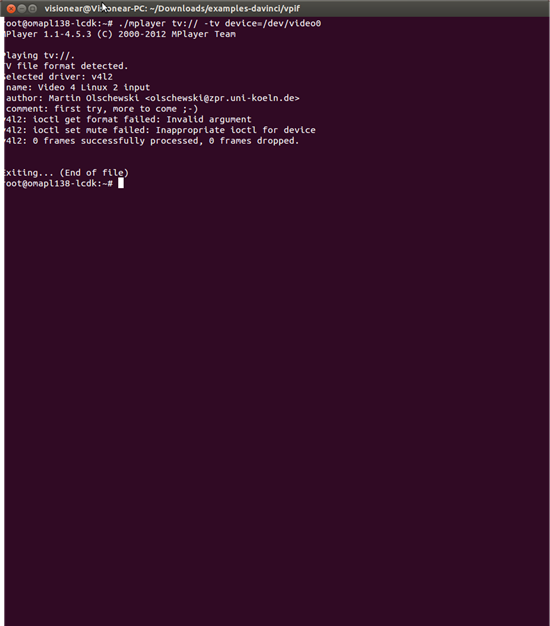

I'm trying to get the composite input of the LCDK board working. Firstly, I follow this post http://e2e.ti.com/support/dsp/omap_applications_processors/f/42/t/339153.aspx. I have used the config file given in the bottom of that post (0763.board-omapl138-lcdk.c, 0028.dot_config_lcdk.txt). According to that post, these config files are for the DaVinci-PSP-SDK-03.22.00.06. However I have succesfully used it for the MCSDK. Now I have /dev/video0 and /dev/video1 show up and my boot log is identical to what given in the last comment in that post.

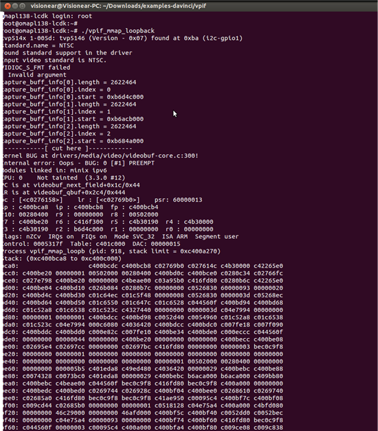

I've tested with loopback application given in this link (http://processors.wiki.ti.com/index.php/Demonstration_of_VPIF_raw_capture_using_MT9T031_sensor_on_AM18X/DA850/OMAP-L138_running_Linux#Setup) and this is what I have thus far
I have add the following code into /driver/video/davincifb.c  to make the code compile
/* see : http://gumstix.8.x6.nabble.com/IO-ADDRESS-definition-missing-in-ti-codec-engine-build-td666095.html */
#define IO_OFFSET               0x01000000      /* Virtual IO = 0xfefb0000 */
#define IO_ADDRESS(x)           ((x) - IO_OFFSET)
and I comment out line 301 of file /driver/media/video/videobuf-core.c
//BUG_ON(V4L2_FIELD_ANY == field);

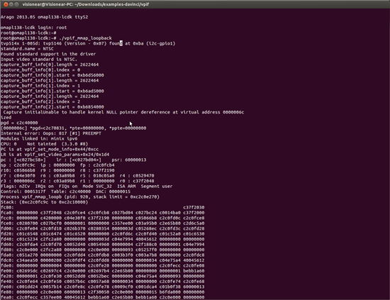

    I have edit the IO_ADRESS macro to the one from hardware.h
    #define IO_PHYS				0x01c00000UL
    #define IO_OFFSET			0xfd000000 /* Virtual IO = 0xfec00000 */
    #define IO_SIZE				0x00400000
    #define IO_VIRT				(IO_PHYS + IO_OFFSET)
    #define io_v2p(va)			((va) - IO_OFFSET)
    #define __IO_ADDRESS(x)			((x) + IO_OFFSET)
    #define IO_ADDRESS(pa)			IOMEM(__IO_ADDRESS(pa))
    #ifdef __ASSEMBLER__
    #define IOMEM(x)                	x
    #else
    #define IOMEM(x)                	((void __force __iomem *)(x))
    #endif

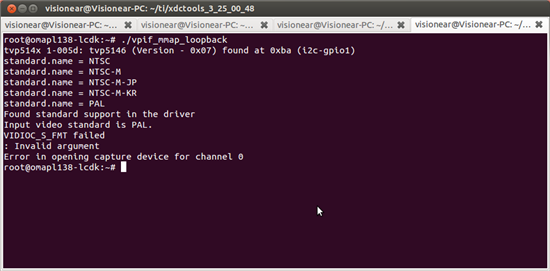

    To clarify what I get now. Firstly the code always failed at line 271 in file vpif_mmap_loopback.c. If I comment out this block, I end up segmentation fault like in the picture below.

    Secondly, If I don't comment out line 301 of file /driver/media/video/videobuf-core.c, this is what I get.
    Thanks you for your help

  • Hi Palm,
    Actually you don't want to change anything on the latest SDK.
    I presume that you are using the latest TI SDK MCSDK1.00.02.
    Able to get video streaming through mplayer ?
    FYI, The above code works well on LogicPD EVM and not tested with LCDK boards.
    You can use "mplayer" tool get video streaming.
    http://e2e.ti.com/support/dsp/omap_applications_processors/f/42/p/328619/1146743.aspx#1146743
    http://e2e.ti.com/support/dsp/omap_applications_processors/f/42/p/328715/1146751.aspx#1146751
  • The code work for the USB webcam but not trough composite input. I try with USB webcam with success but with the composite camera this is what I get.
  • Could you attach your board file here or send to me (x0213399@ti.com)
  • Here is my board file

    1. MPlayer is working with the USB webcam but not my composite camera
    2. vpif_mmap_loopback.c is not working for both USB webcam and the composite camera.
    It gives following error when using with composite camera.

    	CLEAR(*fmt);
    	fmt->type = V4L2_BUF_TYPE_VIDEO_CAPTURE;
    	fmt->fmt.pix.bytesperline = BYTESPERLINE;
    	fmt->fmt.pix.sizeimage = sizeimage;
    	fmt->fmt.pix.pixelformat = V4L2_PIX_FMT_MJPEG;
    	fmt->fmt.pix.field = V4L2_FIELD_INTERLACED;
    	ret = ioctl(*capture_fd, VIDIOC_S_FMT, fmt);
    	if (ret < 0) {
    		perror("VIDIOC_S_FMT failed\n");
    		return -1;
    	CLEAR(*fmt);
    	ret = ioctl(*capture_fd, VIDIOC_G_FMT, fmt);
    	if (ret < 0) {
    		perror("VIDIOC_G_FMT failed\n");
    		return -1;

    		if (-1 == d)
    			break;
    		switch (d) {
    		case 'm':
    		case 'M':
    			input_std = atoi(optarg);
    			if (input_std) {
    				input_std_id = V4L2_STD_PAL;
    				sizeimage = BYTESPERLINE*576*2;
    			break;
    		case 's':
    		case 'S':
    			stress_test = atoi(optarg);
    			break;
    		case 'p':
    		case 'P':
    			print_fn = atoi(optarg);
    			break;
    		case 'c':
    		case 'C':
    			channel_no = atoi(optarg);
    			if (channel_no == 1) {
    				input_device = CAPTURE_DEVICE1;
    				input_name = CAPTURE_INPUT1;
    			break;
    		case 'd':
    		case 'D':
    			display_enable =  atoi(optarg);
    			break;
    		case 'w':
    		case 'W':
    			save_frame = atoi(optarg);
    			break;
    		default:
    			menu();
    			exit(1);
    	if (save_frame) {
    		file_fp = fopen("./capt_frame.yuv", "wb");
    		if (file_fp == NULL) {
    			printf("Unable to open ./capt_frame.yuv\n");
    			exit(1);
    	app_main();
    	return 0;
    and it freeze(cursor blink without any output on the console and vga display) when using with USBwebcam. (I have already edit the code by set the resolution to 640x480 which is supported on my webcam)
    3. camera_test.c doesn't work with both input either but it gives different error message compare with vpif_mmap_loopback.c. (code from http://elinux.org/Testing_Video_Input_of_Hawkboard)
    USBwebcam
    I have to make change to the following line to make it runs
    if (ioctl(cinfo->fd, VIDIOC_S_STD, &std_id) == -1) {
        printf("Unable to set video standard\n");
        //err = EINVAL;
        //goto cleanup_devnode;

    FYI, my vga lcd screen resolution is 1080p (I don't think it causes any problem)
    Thanks you very much for your help
    Palm
  • Hi Palm,
    You can try to use "facedetect" demo which loopback the composite input to VGA output.
    I have tried already this facdetect demo run on my LCDK board with DVD player composite input & composite surveillance camera and able to run successfully but not with LCD (only VGA).
    Need to change "static void SetUpLCD(void)" function for LCD (width, height & PCLK etc.,)
    ti/c6sdk_02_00_00_00/demos/facedetect/src/facedetect_lcdk.c.
    http://processors.wiki.ti.com/index.php/BIOS_C6SDK_2.0_User_Guide#Facedetect
    http://processors.wiki.ti.com/index.php/BIOS_C6SDK_2.0_Getting_Started_Guide
    I don't have a LCD for LCDK board.
  • I don't have the LCD screen either. The display I use to test is my 1080p vga display. I will try the code and get back with you soon.
    Thank you for your help
    Palm
  • This code is for the C6748 lcdk and run without any operating system. How can I run it on the ARM side of my OMAP-L138 lcdk board? I don't think it is possible.
    By the way, do you have any idea on what is actually the problem with my code and configuration? I have tried to capture and write all the detail regarding my problem. If there is anything you would like to know, I could upload more file and do more testing.
    Palm
