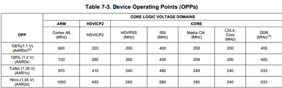

By checking the console about clock,
L3 clk : 240MHz
IVA clk : 390MHz
ISS clk : 480MHz
DSS clk : 240MHz
ARM clk : 720MHz
DDR clk : 533MHz
And confirm DM385 and DM388 DaVinci Digital Media Processor (Rev. D)
I know the following
       A8 clock is up to 1000-MHz
       Supports up to 400 MHz for DDR2, 533 MHz for DDR3, and 533 MHz for DDR3L
But how about the upper limit in others?
L3 clk : 240MHz             ?
IVA clk : 390MHz            ?
ISS clk : 480MHz            ?
DSS clk : 240MHz          ?
ARM clk : 720MHz        1000
DDR clk : 533MHz         533
