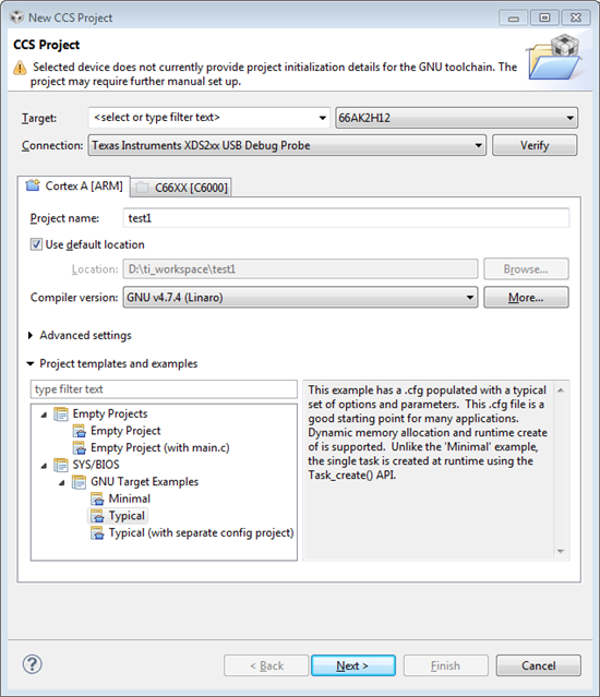

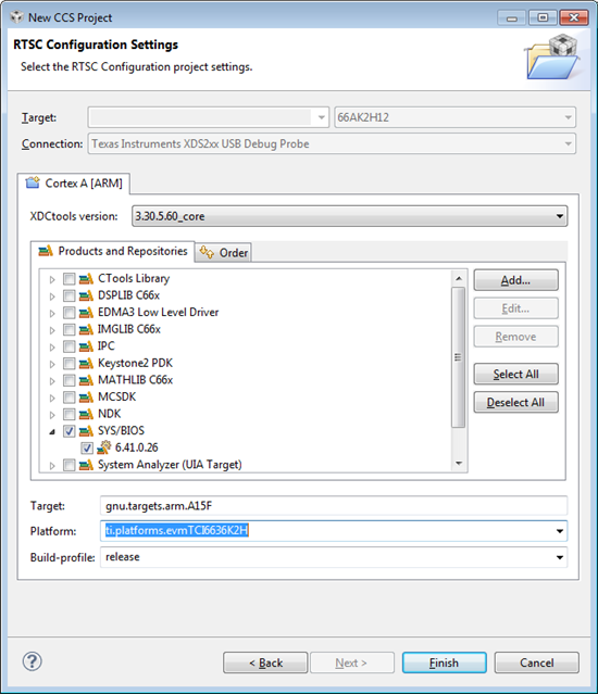

I did New project -> sysbios-gnu examples->typical

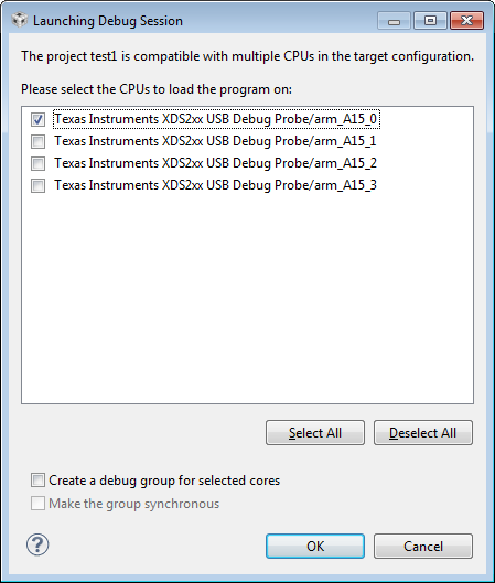

i build, clicked debug, using first core
Then i get

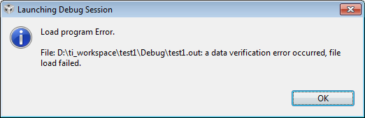

console reports:
arm_A15_0: Trouble Reading Memory Block at 0x80000000 on Page 0 of Length 0x4: (Error -1205 @ 0x80000000) Device memory bus has an error and may be hung. Verify that the memory address is in valid memory. If error persists, confirm configuration, power-cycle board, and/or try more reliable JTAG settings (e.g. lower TCLK). (Emulation package 5.1.600.0)
arm_A15_0: File Loader: Data verification failed at address 0x80000000 Please verify target memory and memory map.
arm_A15_0: Unable to terminate memory download: NULL buffer pointer at 0x3aa4
arm_A15_0: GEL: File: D:\ti_workspace\test1\Debug\test1.out: a data verification error occurred, file load failed.

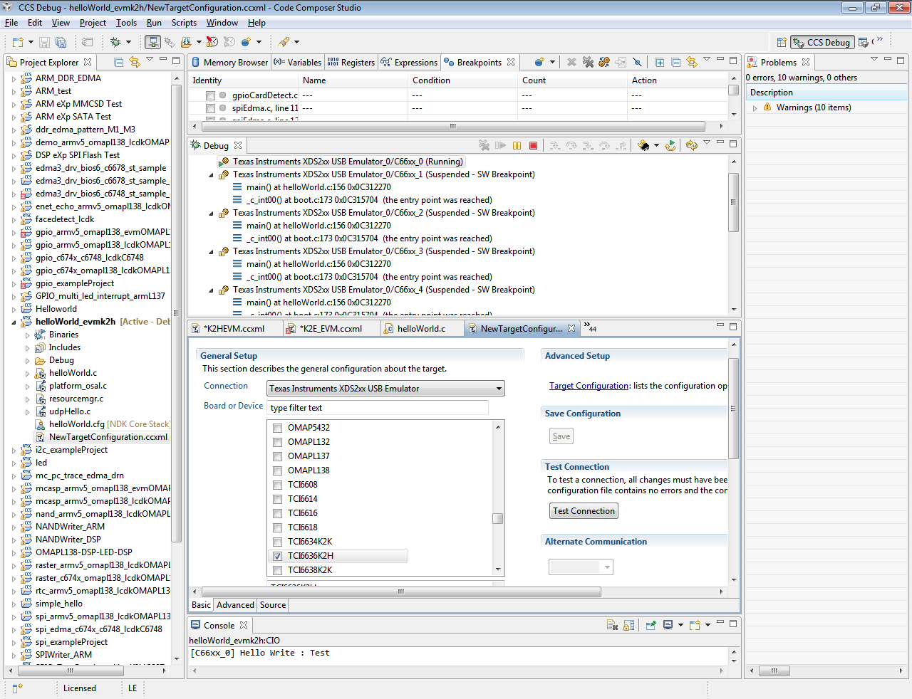

  • Hi Lars,
    If I understand correctly, are you trying to load and run some sample program on K2H using CCS?
    If yes, you can follow the below steps.
    1. Download and install the mcsdk_bios_3_00_03_15 package.
    2. open CCS import the hello world project located at "..\ti\mcsdk_bios_3_00_03_15\examples\ndk\helloWorld\evmk2h" and build
    3. Connect the K2H board, open the *.ccxml file, select the approprate emulator (XDS2xx USB ) and board as TCI6636K2H , save and test connection.
    4. open the debug session and run the hello world program on target.
