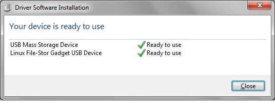

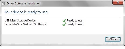

  • Hi Pavel,
    When using TI EVM, I get now responsive from windows, but I expected to find new device in "my computer" (windows 7). Do you know where it should be found ?
    root@dm814x:~#dd if=/dev/zero of=fsg.block bs=1M count=16
    root@dm814x:~# modprobe g_file_storage file=/home/root/fsg.block stall=0
    g_file_storage gadget: No serial-number string provided!
    g_file_storage gadget: File-backed Storage Gadget, version: 1 September 2010
    g_file_storage gadget: Number of LUNs=1
    g_file_storage gadget-lun0: ro=0, nofua=0, file: /home/root/fsg.block
    root@dm814x:~# musb g_file_storage gadget disconnected.
    root@dm814x:~# g_file_storage gadget: high speed config #1
    Ran
    When I use the sata device instead of empty file (dd) as following then windows ask me to format new device (F:):
    modprobe g_file_storage file=/dev/sda1 buflen=65536 stall=0 removable=1
    Anyway, it means that device works OK probably (I did not try to format yet), though I don't know why the first try (empty file with "dd" command) is not recognized as new symbol.
    Ran
