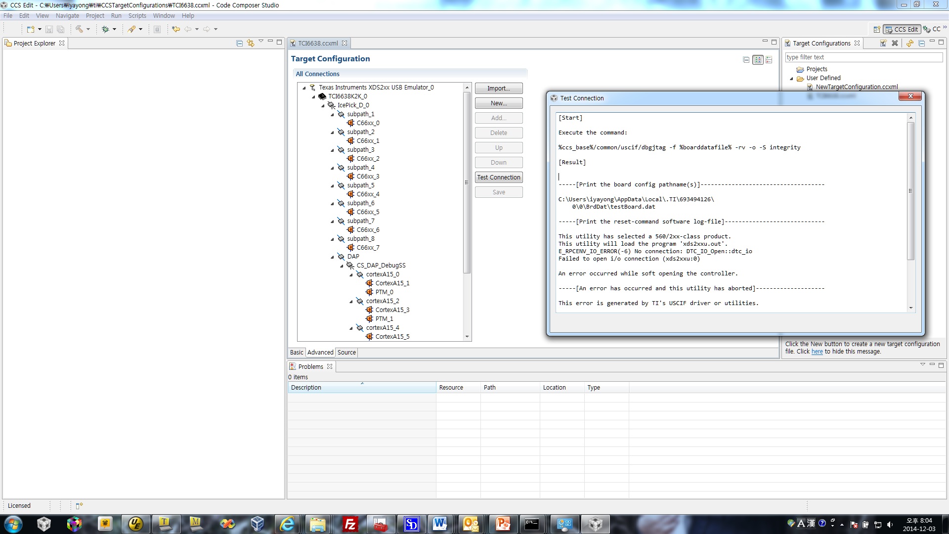

I have serious problem about connect emulator which embeded on XTCIEVMK2X
below log is trouble shoot when I try to connect tci6638 with CCSV5.x
[Start]
Execute the command:
%ccs_base%/common/uscif/dbgjtag -f %boarddatafile% -rv -o -S integrity
[Result]
-----[Print the board config pathname(s)]------------------------------------
C:\Users\iyayong\AppData\Local\.TI\693494126\     0\0\BrdDat\testBoard.dat
-----[Print the reset-command software log-file]-----------------------------
This utility has selected a 560/2xx-class product. This utility will load the program 'xds2xxu.out'. E_RPCENV_IO_ERROR(-6) No connection: DTC_IO_Open::dtc_io Failed to open i/o connection (xds2xxu:0)
An error occurred while soft opening the controller.
-----[An error has occurred and this utility has aborted]--------------------
This error is generated by TI's USCIF driver or utilities.
The value is '-250' (0xffffff06). The title is 'SC_ERR_ECOM_EMUNAME'.
The explanation is: An attempt to access the named emulator via USCIF ECOM has failed.
[End]

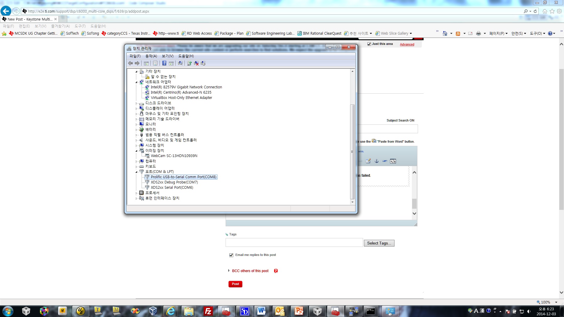

But in my system there exsit xds200 debug port and uart port like this
I tried to change USB port and re-install FTDI driver but it's not working at all.
How can I solve this problem. Let me know
ps. is there any problems when using serial to usb cable? I think the serial cable just using as debugging.

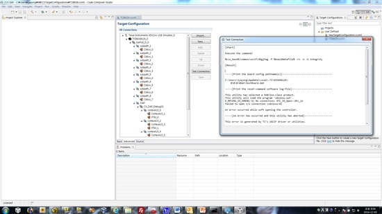

    6. I just test connection with TCI6638K2K target , EVM board to CCS, therer are no code,
    7. when I tried to target connect to CCS there are log which below came out
    [Start]
    [Result]
    [End]
