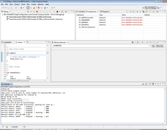

    I hope, You build the client example successfully, then loaded and run on EVMC6657 board.
    Did you connect the ethernet cable between your work setup(Like EVM RJ-45 and Your LAN)?

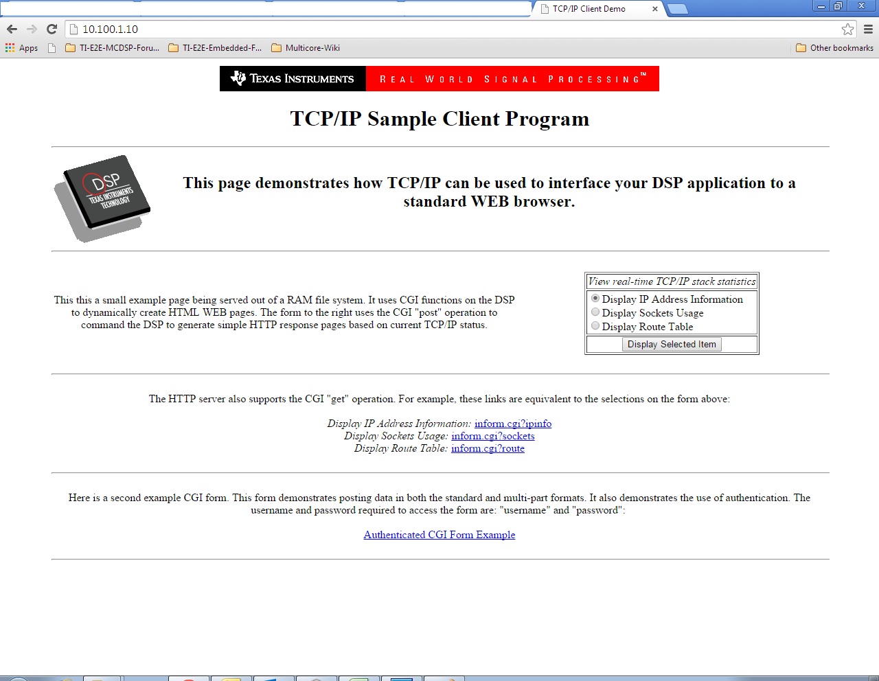

    I could not see any IP address on your console. If you get the Board IP address on the console, you can access that IP on the browser. Refer the attached snapshot.
