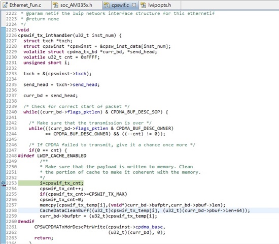

I'm using AM335X with ethernet and develop on starterware 02_00_01_01
When I setup ethernet register it's work normally, both web server is work.
But after I keep refresh web browser shortly, the ethernet is stall.
Even ping is not reachable.
I find TX0_HDP register is block when ethernet stall, and
cpswif_tx_inthandler is into timeout procedure.
Dose any idea to defend tx blocking or solve when tx is blocking?
Hi, thanks for reply
Sorry, LWIP_CACHE_ENABLE is my test procedure, I have remove it and test/post again
First picture is capture when interrupt generator.
Second picture is capture when ethernet block then I suspend by tool
Have any idea to defend tx blocking or solve when tx is blocking?
