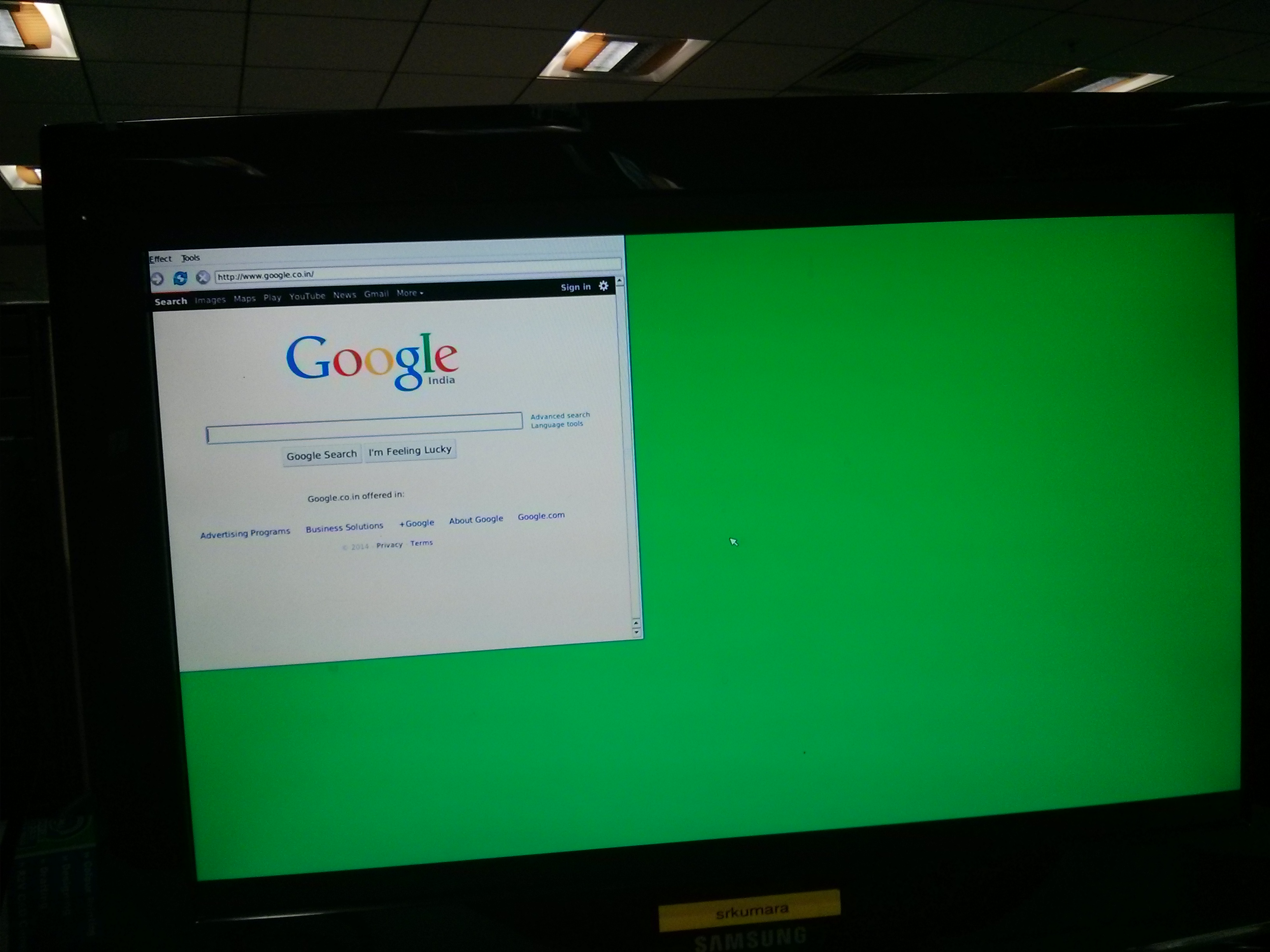

 I tried to launch Qt Fancybrowser in DM814x EVM and the browser window launches wih the green background behind. Please help me on what could be the reason for this green background?
    I have tried it on EVM with EZSDK and I am not seeing the green screen.
    Probably you are seeing it because somewhere it is set to green.
    You could try to search in the code.

  • Can you please try launching it in /dev/fb1
  • Hi Margarita,
      This is an issue in ezsdk. I took a fresh ezsdk  and booted up the EVM. The browser launched from MatrixGUI is fine. But when we try to launch Qt fancybrowser in LCD as well as in HDMI, we get the green background as shown in the picture
    This happens for all graphics pipeline. either it is /dev/fb0 or /dev/fb1
    root@dm814x-evm:/usr/bin/qtopia/examples/webkit/fancybrowser# ./fancybrowser -qws http://www.google.co.in
    Please find the logs below

    I have ran it on the EVM with LCD, I still doesn't see any green issue.
    Margarita
    If you launch browser from Matrix GUI we do not get it. But when you launch browser standalone not with Matrix GUI, we get the green background.
    I had upgraded QT also to check whether this issue is with Qt. But the green background persists
    Can you please run fancybrowser standalone as mentioned below
    root@dm814x-evm:/usr# cd bin/qtopia/examples/webkit/fancybrowser
    Please provide me suggestions on how this can be avoided.

    I am able to reproduce it when the MATRIX GUI is stopped.
    I will check and I will let you know.
