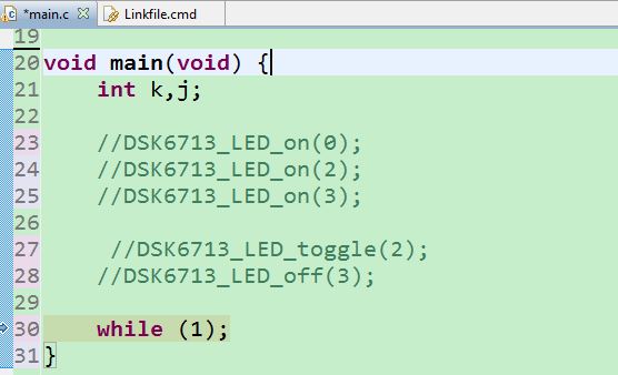

Here I would like to demonstrate an example with the snapshot:
Remark: in this example, I repeatedly called DSK6713_LED_on(i) to illuminate one of the LEDs. However, when I called DSK6713_LED_on(2), the 2th and 3rd LED turned on together.  If I called DSK6713_LED_on(0), the 0 2 3 LED turned on together!
Although there was zero errors or warnings, this LED control was not stable.

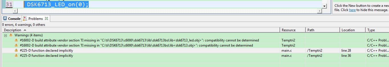

The teacher told me I should use DSK6713_LED_on(i) as the LED API to control the LED. But the compiler reported warnings like this:

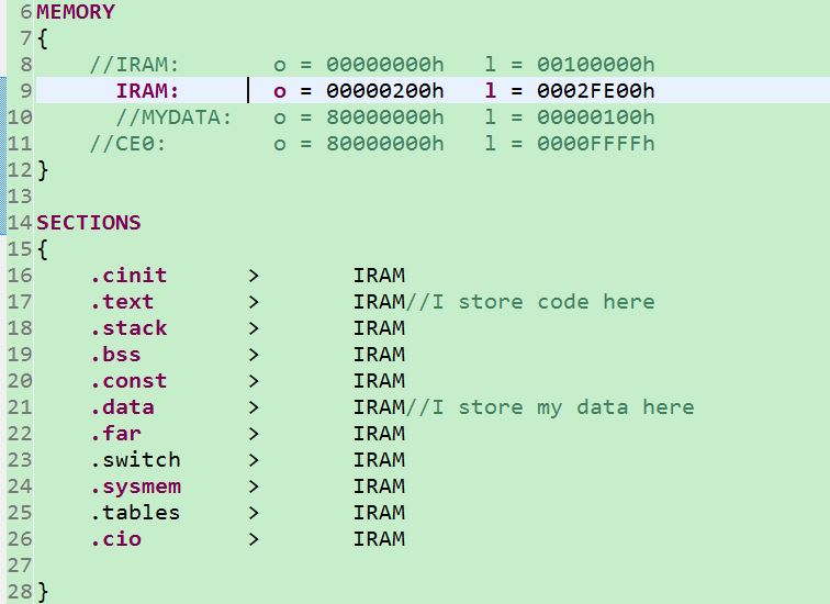

The cmd file:

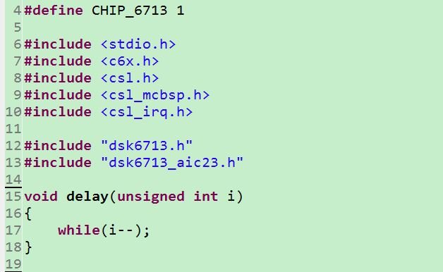

2-I inadvertently forgot to add necessary ".h" file at the beginning of the .c file.   Calling certain API requires adding certain ".h" file.
But here my ".h" file should be correct.
