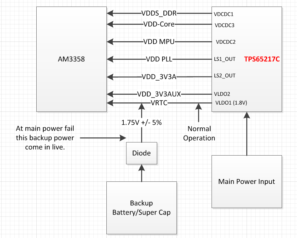

  • Thanks Biser,
    its mean I have no need to use any external RTC, if alternate battery power use with diode arrangement as shown in attached block diagram.
  • No, this connection diagram is wrong. VRTC must be 1.8V +/- 5%. See AM335X Datasheet Rev. G section 5.5, requirements for VDDS_RTC.

    I cannot understand why this block diagram (posted in previous post) is wrong, as per section 5.5 of AM335x data sheet VRTC must be 1.8V +/-5%.(1.71 to 1.8volt)| and my back up power provide 1.75 to 1.8 volt as shown is new block diagram attached
    according to TPS65217c data sheet VLDO1 = 1.8V. so if I connect a backup battery with diode arrangement which will give 1.8V volt then why this will connection diagram will not work.
    and this following block diagram is ok?
    please clear me is this arrangement are wrong what will be the right way to connect this.
  • 1.75V +/- 5% makes a voltage range from 1.6625V to  1.8375V. The recommended range is from 1.710V to 1.890V.
  • I would also like to underline that VRTC needs to be a stabilized power supply. A coin cell/supercap cannot provide this.

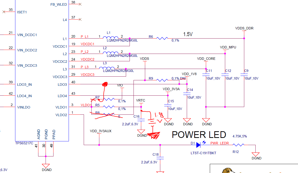

  • I checked the TPS65217 User Guide. The reason it states that TPS65217C/D cannot be used for RTC-only mode is that in the connection diagram VDDS is also supplied from LDO1. You can supply VDDS however, from LDO3 and leave LDO1 only for VDDS_RTC. In this case however you will need to have a Li+ battery attached to the PMIC if you intend to remove external power completely..

    I think now i am got the solution  and this following image circuit is fine as, now i am connection VDDS and VIO at LDO3 along With VDD1v8 net and  VLDO1 has only VTRC signal net. and Li batt.
    previously VIO and VDDS are connected at VLDO1 along with VRTC.
    in above sch now i am going to DNI R8 and R9 will install. and R7 will connect at pin 40 instead of pin 3 of tps65217c
  • Attaching a battery cell directly to the VRTC power rail is absolutely unacceptable. When I mentioned battery, I meant the BAT pins of the PMIC. Please find some time and read the TPS65217C datasheet.

    Our product will run off Li-Ion cell battery connected to the TPS65217C. This must be a valid battery option.  I was only confused by the statement in the user guide that TPS65217C doesn’t support RTC-only mode.  I think the thread you suggested provides an answer:
     “I checked the TPS65217 User Guide. The reason it states that TPS65217C/D cannot be used for RTC-only mode is that in the connection diagram VDDS is also supplied from LDO1. You can supply VDDS however, from LDO3 and leave LDO1 only for VDDS_RTC. In this case however you will need to have a Li+ battery attached to the PMIC if you intend to remove external power completely..
    So basically it has nothing to do with the PMIC itself – it’s the way the PMIC is connected to the rest of the system. In our design VLDO1 is connects to the VDDS_RTC only so theoretically RTC-only mode should work fine.

  • I agree with his comments - the way he suggests connecting VDDS should work for RTC-only mode.
  • I am also looking into implementing this modification to the connection of VDD_RTC.    One thing that was not addressed in the response is whether it is appropriate to connect VIO to VDD_RTC or 1.8V.   The difference would be whether the PGOOD and LDO_PGOOD signals can be driven to the processor when in RTC only mode.  It seem like they should not be driven when the only power is VDD_RTC, so therefore counter to the manual VIO should get connected to 1.8V on LDO3, is that correct?
    Also, I've been chasing a comment on the BBB board discussing the need to connect VDDS to VDD_RTC because of a requirement from TI - the only thing I can find relating to this is the power down sequence, 335x datasheet, rev H states:  "The VDDS power supply must ramp down after all 3.3-V VDDSHVx [1-6] power supplies."   I can't see how connecting VDDS to LDO3 could create this problem, any advice here?
  • I've looked into the VIO thing further and see that all of the inputs that go to the am335x are powered by VDD_RTC, so there is no issue - it is pretty clear that VIO should be connected to VDD_RTC.
    The outstanding question is my second:
  • VDDS connected to LDO3 should not create any problems. VDDS to VDD_RTC is not a proper connection and is not recommended.
