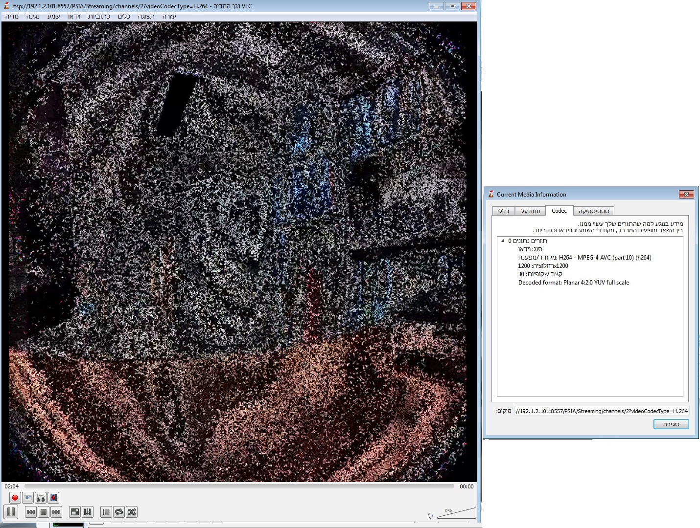

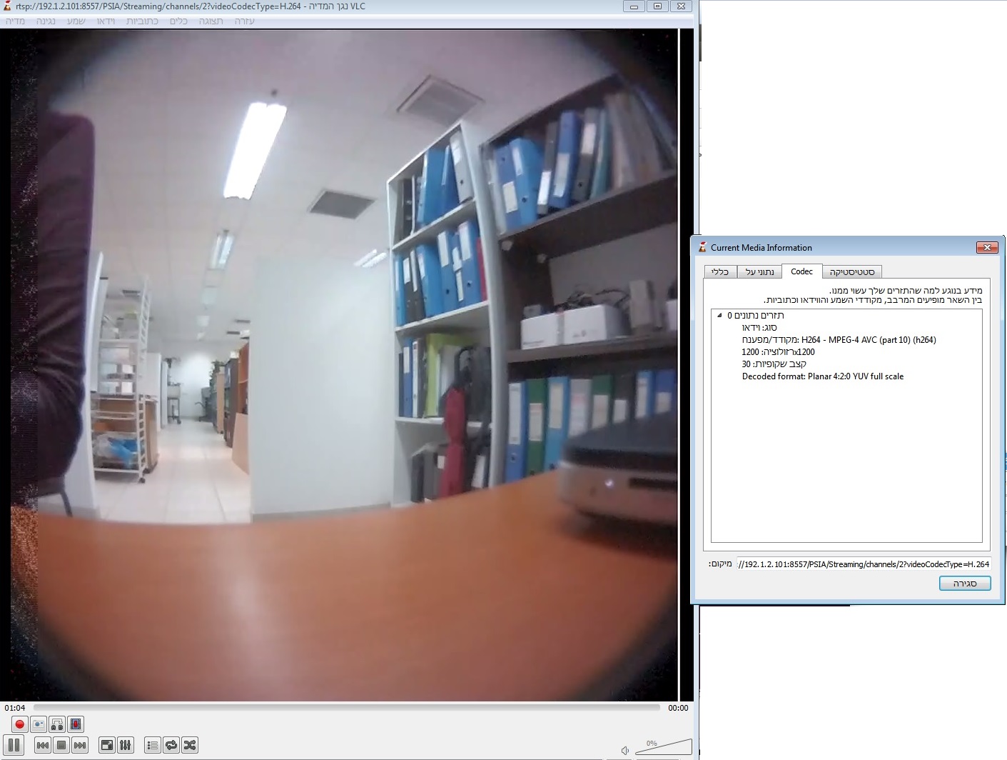

  • Hello Anand,
    Good news - I was able to get the 1200x1200 resolution working with AEWB...
    I had to make changes in issdrv_mt9j003Api.c and multich_tristream_fullfeature.c.
    I also had to turn off the SALDRE - because when it was working, I got weird black/white overlays on my picture (see above).
    Here's what the picture should look like. Also - there's a black bar on the good picture (below) which went away when I shut off the SALDRE.
    Any ideas about this?
    Mechi

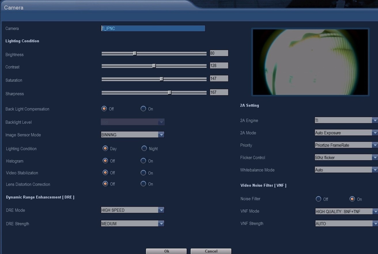

  • Today was cloudy - went out to capture some frames using default 1080p usecase with the APPRO camera. It doesn't seem that the AE or SLADRE are working. Even when I changed the brightness from 128 to 80, there was very little difference seen.
    Maybe some other setting should be changed. This is the only screen that I entered to try setting up the camera.
    If I shut off the AE,
    • how can I control R,G1,B,G2 gains manually in order to get a good picture with good color?
    • how can I control exposure (shutter) manually?
    Mechi
    The minExposure and maxExposure for the J003 sensor are 5000 us and 16667 us respectively.
    I tested the 1200x1200 resolution use case pointing the camera to a light source under indoor lighting condition and i could see the sensor exposure time hitting the minExposure time of 5000 us.
    Can you confirm the similar behaviour on your side?
    If required i can provide my binaries which you can test.
    regards,
    Anand
