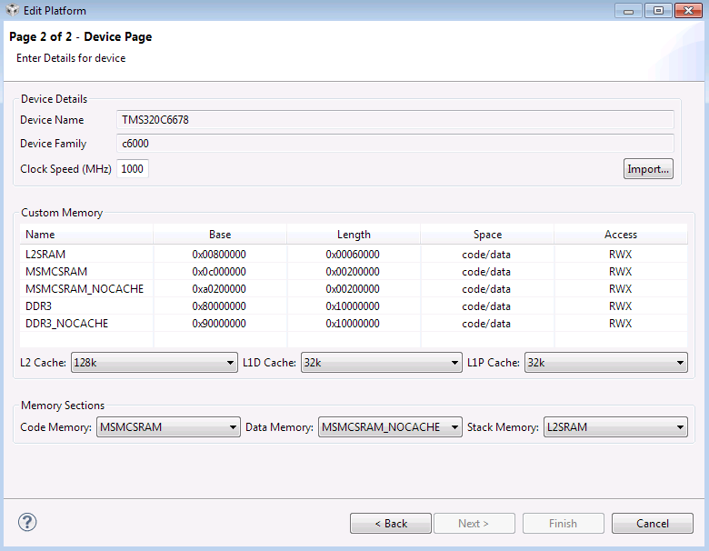

I'm trying to combine NDK and OpenMP and I have a problem.
For this I'm using demos.image_processing.openmp.evmc6678l.platform and image_processing_openmp_evmc6678l.cfg file but as a result I'm getting this error:
Segment: 0xa0200000 overlaps with: SL2_RAM
Maybe somebody knows how to fix this error?

  • Hi Rajasekaran!
    Thank you for reply!
    I reviewed platform and .cfg file, but didn't see something wariosly (I'am new in DSP programming).
    The platform is:
    The .cfg file is:

    I tryed to do this with new SYS/BIOS, XDCtools and IPC, but result the same:
    **** Build of configuration Debug for project helloworld_evmc6678l ****
    "c:\\ti\\ccsv6\\utils\\bin\\gmake" -k all
    'Building file: ../test_eth_ndk.cfg'
    'Invoking: XDCtools'
    "C:/ti/xdctools_3_30_05_60_core/xs" --xdcpath="C:/ti/ctoolslib_1_0_0_2/packages/ti;D:/Ermolenko/Project_work/CCS/myPlatform_lib;C:/ti/mcsdk_2_01_02_06;C:/ti/dsplib_c66x_3_2_0_1/packages;C:/ti/edma3_lld_02_11_05_02/packages;C:/ti/imglib_c66x_3_1_1_0/packages;C:/ti/ipc_1_25_03_15/packages;C:/ti/mathlib_c66x_3_1_0_0/packages;C:/ti/mcsdk_2_01_02_06/demos;C:/ti/pdk_C6678_1_1_2_6/packages;C:/ti/ndk_2_24_01_18/packages;C:/ti/nsp_1_10_02_09/packages;C:/ti/openem_1_0_0_2/packages;C:/ti/omp_1_02_00_05/packages;C:/ti/bios_6_41_00_26/packages;C:/ti/tirtos_c6000_2_00_01_23/packages;C:/ti/tirtos_c6000_2_00_01_23/products/bios_6_40_01_15/packages;C:/ti/tirtos_c6000_2_00_01_23/products/ipc_3_10_01_11/packages;C:/ti/tirtos_c6000_2_00_01_23/products/ndk_2_23_01_01/packages;C:/ti/tirtos_c6000_2_00_01_23/products/uia_2_00_00_28/packages;c:/ti/ccsv6/ccs_base;" xdc.tools.configuro -o configPkg -t ti.targets.elf.C66 -p demos.image_processing.openmp.evmc6678l.platform -r release -c "c:/ti/ccsv6/tools/compiler/c6000_7.4.8" "../test_eth_ndk.cfg"
    making package.mak (because of package.bld) ...
    generating interfaces for package configPkg (because package/package.xdc.inc is older than package.xdc) ...
    configuring test_eth_ndk.xe66 from package/cfg/test_eth_ndk_pe66.cfg ...
    error: ti.sdo.ipc.SharedRegion: "C:/ti/ipc_1_25_03_15/packages/ti/sdo/ipc/SharedRegion.xs", line 367: ti.sdo.ipc.SharedRegion : Segment: 0xa0200000 overlaps with: SL2_RAM
    js: "C:/ti/xdctools_3_30_05_60_core/packages/xdc/cfg/Main.xs", line 160: Error: Configuration failed!
    gmake.exe: *** [package/cfg/test_eth_ndk_pe66.xdl] Error 1
    js: "C:/ti/xdctools_3_30_05_60_core/packages/xdc/tools/Cmdr.xs", line 51: Error: xdc.tools.configuro: configuration failed due to earlier errors (status = 2); 'linker.cmd' deleted.
    gmake: *** [configPkg/linker.cmd] Error 1
    gmake: Target `all' not remade because of errors.
    **** Build Finished ****
