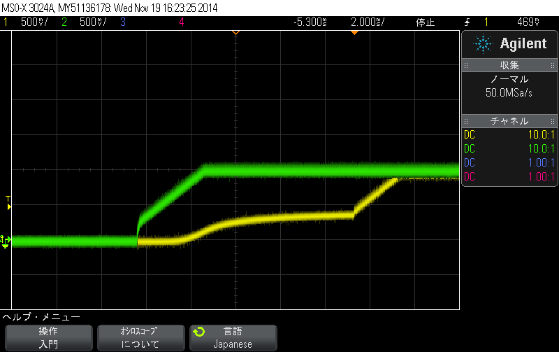

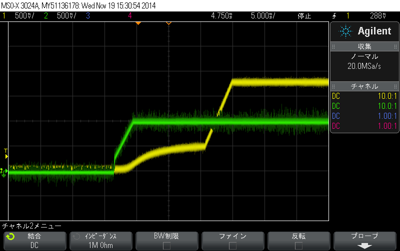

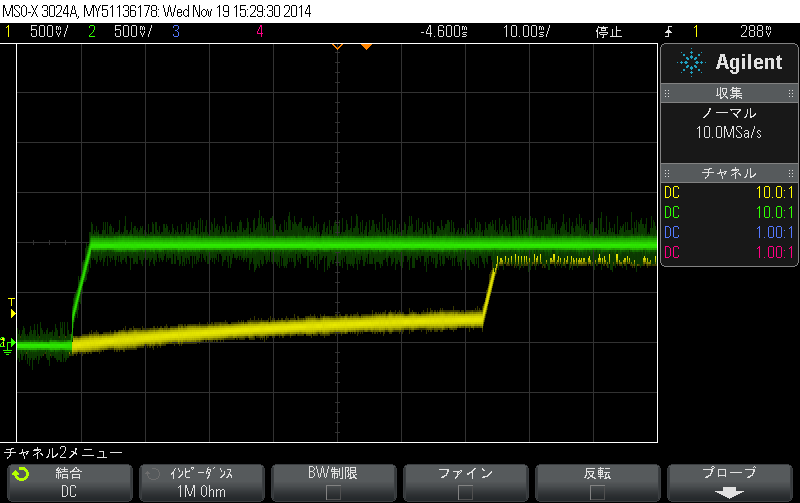

I have question about ramp up voltage of 66AK2H12.
I am checking  the power sequence on EVMK2H.
Then, the following waveform was observed.
0.85V(VDDALV・VDDUSB・VPTX・VP) 0.95V(CVDD1・CVDDT1・VNWA) and 1.8V(AVDDA・VDDAHV・DVDD18) are ramped up
in spite of these voltage are not supplied, when 1.0V(CVDD) is supplyed.
Green: 1.0V(TP11)
Yellow: 0.85V(R320)
Green: 1.0V(TP11)
Yellow: 1.8V(TP50)
Green: 1.0V(TP11)
Yellow: 0.95V(L6)
It seems that these minor drift up occur by the leakage current of 1.0V(CVDD).
Is my opinion correct? and does this behavior is normal?
