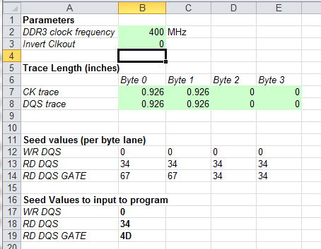

So, I tried to get the correct ratio values for the DDR3 PHY configuration. And then another issue occurs. Unlike our previous board where the CK and DQS trace lengths are about 3.5 to 4 inches long, this new board only uses 0.926 inches on both CK and DQS. Byte-wise SW leveling gave a result of 0 on all the parameters. Word-wise SW leveling gives a bunch of errors regarding RD DQS/RD DQS GATE/WR DATA RATIO MINIMUM VALUE DIDN’T CONVERGE and then gave a result of 0 on all the parameters.
Thus, a new set of questions came up.
  1. What values should be entered for Byte 2 and 3 if only 16-bit data bus width is used? We entered zero in our case.
  1. Does both DDR3 byte-wise and word-wise software leveling requires that 4-byte lane is used? Does the DDR3_SlaveRatio_ByteWiseSearch_TI814x.out and DDR_slave_ratio_search_TI814x.out know when only 2-byte lanes are used instead of 4-byte lanes?
  1. If the CK and DQS trace have equal length, what should the value of Invert Clkout be? Is it 0 or 1?
  1. What does it mean when Software Leveling is giving a result of 0 on all the required parameters? What does the error RD DQS/RD DQS GATE/WR DATA RATIO MINIMUM VALUE DIDN’T CONVERGE means?
  1. Is there a minimum DDR3 CK and DQS trace length for AM3874?
Anyway, since 0 does not seem to be an appropriate value for the DDR3 PHY configuration, I ended up using the values we were using for our previous board (even though the trace is 4 inches compared to less than 1 inch). A funny thing happened after making this change. The error in start_armboot() where gd address is incorrect was suddenly fixed. Thus, u-boot goes further. However, it will still do a data abort at a later place. U-Boot serial console message is still not present. Thus, it looks like the issue is a DDR3 configuration issue.

    It would really be helpful to get answers to the following questions I posted before as changing the values for the DDR Software Leveling makes some difference. But, we can't use either the Byte-wise or Word-wise SW leveling because it always give us values of zeroes.
    1. What values should be entered in the TI Ratio Seed for Byte 2 and 3 if only 16-bit data bus width is used? We entered zero in our case.
    2. Does both DDR3 byte-wise and word-wise software leveling requires that 4-byte lane is used? Does the DDR3_SlaveRatio_ByteWiseSearch_TI814x.out and DDR_slave_ratio_search_TI814x.out know when only 2-byte lanes are used instead of 4-byte lanes?
    3. If the CK and DQS trace have equal length, what should the value of Invert Clkout be? Is it 0 or 1?
    4. What does it mean when Software Leveling is giving a result of 0 on all the required parameters? What does the error RD DQS/RD DQS GATE/WR DATA RATIO MINIMUM VALUE DIDN’T CONVERGE means?
    5. Is there a minimum DDR3 CK and DQS trace length for AM3874?

    Here are my original questions again.
    1. What values should be entered in the TI Ratio Seed for Byte 2 and 3 if only 16-bit data bus width is used? We entered zero in our case. Should this be left blank instead?
    Here is an example case where byte-wise SW leveling have issues. This is using the Ratio values in my original post (400 MHz DDR3).

  • Maynard,
    In both cases (0 and blank) it gives the same result. So you can enter 0.
    16-bit data bus is supported for the AM335x device SW leveling, so you might use it as a reference. Note that Word wise SW leveling is used for 32-bit and 16-bit DDR interfaces, while byte wise SW leveling is used for only 32-bit DDR interface. Word Leveling is only applicable for slow interfaces.
    http://e2e.ti.com/support/dsp/davinci_digital_media_processors/f/716/t/371898
    I think yes (based on the below):
    Data macro for each byte lane is leveled independently. The Slave ratio search program will calculate optimal values for each byte lane.
    But this is valid for the byte wise SW leveling. It seems to me that Word wise SW leveling needs all 4 bytes, thus do not support 2 bytes only:
    I think 1 (based on the below info)
    If the clock trace is longer than the DQS trace use a '0' – otherwise use a '1'

  • Hi Pavel,
    Thanks for answering the questions I have.
    This is actually confusing. It is still not clear which one should be used on our 16-bit only data bus width DDR3 board: Byte-wise or Word-wise? Our intended frequency is 1 GHz AM3874 and 533 MHz DDR3. So, DDR is not a slow interface. Based on this, do I use byte-wise then?
    I will try this again. I did try this before and using 1 for invert clock still gives me the not converging errors and results of mostly zero on byte-wise SW leveling.
