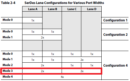

My customer used SRIO in the following condition.
Table 2-4 SerDes Lane Configurations for Various Port Widths(SPRUGW1B)
    Configuration 4  Mode3 : x2 lane, x2 port

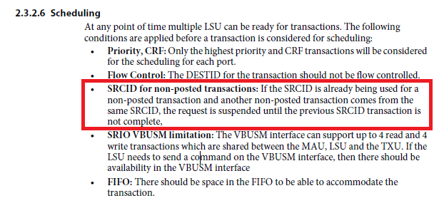

Q2.  If multiple ports receive packets containing the same SRCID, dose the following constrain in SRIO UG consider
        the receiving ports? That means that SRIO peripheral handles these packets as "same SRCID transaction" or NOT.
    ANSWER: The text you highlighted in RED is for the LSU, which is a logical layer transmitting block. It has nothing to do with RX ports. The LSU can send/track 16 outstanding packets at a time that are part of one transaction. For example, you program the LSU to send 4KB, it will blast out 16 256B packets as fast as it can, without waiting for any reponses. However, it will not move to the next LSU shadow register until all responses of the preceding transaction are recieved. If two separate LSUs try to reuse the same SRCID/DESTID pair, it will also wait until the first one is done.
