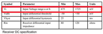

    My customer is using only AC coupling capacitors to connect the Serdes I/F as SRIO, SGMII and PCIe.
    However, they were measured at the receive pin(SGMII_RXP/N) of 66AK2H12, The measured waveform is swinging around 0V.
    We think that the above results do not meet the DC level of the SGMII specification.
    ・Serial-GMII Specification
    Q1: Do we need DC offset with external termination?
    Q2: SRIO, PCIe is also swing to 0V center, do we should be similarly DC offset?
    H.U
  • Hello H.U,
    I guess the customer is probing the signal across P and N lines. If so, the waveform would swing around 0V only as they are probing differential signal.
    The Vi in receiver DC specification shows the signal range for single ended line, either a or b. So i would suggest the customer to probe either a or b with respect to ground point and check the signal range against this specification.
    Senthil
  • Hi, Senthil
    Thank you for your reply.
    They are probing the signal across P and GND, N and GND. Not across P and N lines.
    In addition, Similar waveform is measured even 66AK2H12 EVM.

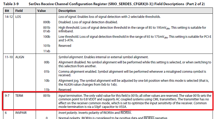

  • Hello H.U,
    I have something to update you on TERM field.
    The SGMII_SERDES_CFGRXn register has TERM[9:7] field does set the termination for the receiver but you are incorrect in your expectation that a DC bias should be applied at the receiver.
    SGMII connections require the DC blocking capacitors between the transmitter and the receiver. For this type of connection the TERM setting of 100 is used to specify a termination with the common point around ground.
    The PHY used for SGMII is general purpose and does include capabilities for other types of termination but none of these have been tested with the KeyStone products and are not supported for use. The only setting tested is the 100 specified in SPRUGV9D. By setting these bits to 000 you have added a DC bias at the receiver which is not supported.
    Senthil

  • Hello H.U,
    Sorry for the delay. Here is the response from the internal team.
    In an AC-coupled link, the AC-coupling capacitor blocks the transmitter DC common mode voltage, so the common mode voltage is set entirely by the RX side through the TERM setting.
    For TERM setting of b’100, this requires a 0V common mode with common mode termination direct to GND.
    For TERM setting of b’000, this is for a DC-coupled link using CML transmitters with the common mode voltage determined by both the transmitter and receiver. But DC-couple link is not supported by the SGMII spec.
    Senthil

    Q1: SRIO document is described that TERM setting is b'100 for common point to 0.8VDDT.
    Is it correct to swing around 0.8VDDT? but, SRIO signals to swing around ground when we were measured...

  • Hi H.U,
    There appears to be some confusion on this thread. The  SGMII_SERDES_CFGRXn register which includes the TERM bits is specific to KeyStone I and does not appear in the memory map for the K2H products. The termination in the KeyStone II SOCs is not programmable and the DC common mode voltage is set to ground.  We will update the SGMII user's guide to clarify that those serdes configuration registers are specific to the KeyStone I family of components.
    Bill

  • Hi H.U,
    I was not clear. For all KeyStone II SOCs, there is not TERM setting available for any of the serdes interfaces. The register that includes the TERM bits is only present in the KeyStone I SOCs. All KeyStone II SOCs have the DC common mode voltage set to ground for the Rx inputs. This cannot be adjusted.
    Bill
  • Hi, Bill
    I am grateful for your quick support.
    The reason that serdes single-end measurement is swinging around 0V at Rx input became clear.
    I expect that the document will be as soon as possible maintenance.
    H.U
