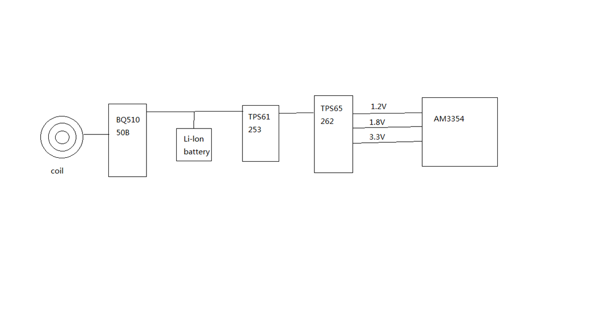

Dear support,
I am working on a new project with AM3354(ZCZ package), I list the system block as folow, is it appropriate for AM3354?
Please see the recommended AM335X power supply solutions here: http://processors.wiki.ti.com/index.php/AM335x_Hardware_Design_Guide#Designing_the_Power_Subsystem
