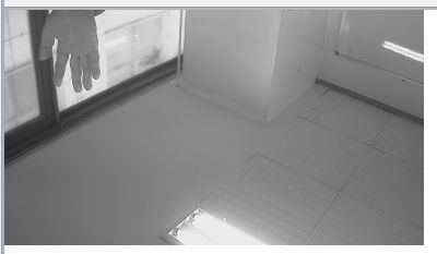

Raise the images resulted in here.
Background image during initialization (pCurrentMean on initialization task)

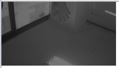

Current Luminance after 3 minutes (pCurImgLuma)

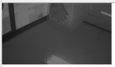

Current Background after 3 minutes (pCurrentMean)
