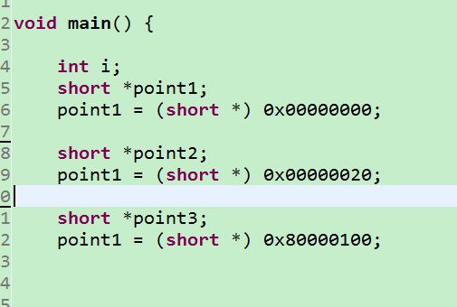

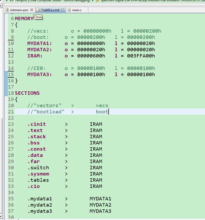

   I use three pointer variable at .c file.  The first and second pointer points to the IRAM address and the third points
to the CE0 of C6713.

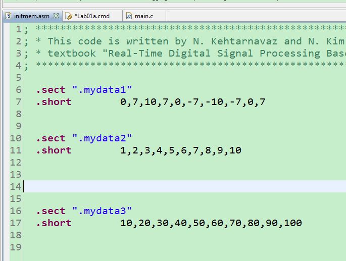

Then I created three sections of digits at asm:

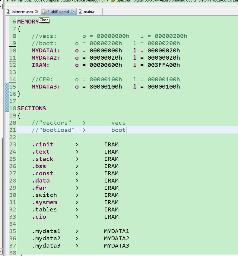

And I use cmd file to allocate space for these 30 digits:
Notice that there is no overlap.

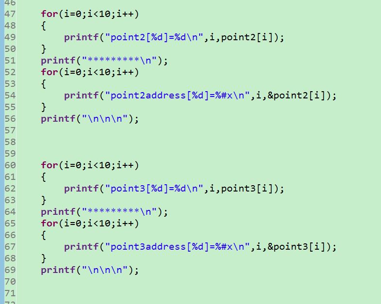

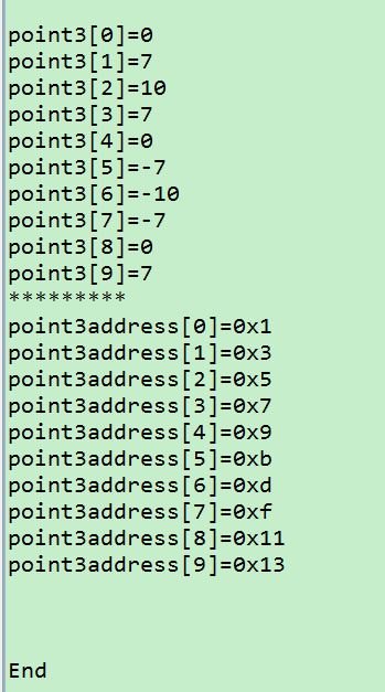

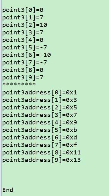

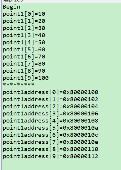

However, when I try to print the 30 digits out and their address out by using the pointer, why I could successfully
print the first and third section of digits out but the second section failed?
Remark: you see, the second sections of data cannot be extracted and the pointer pointed randomly to some other
address.
Could you please tell me why this happens?  Is the pointer variable always unstable or I did something wrong with
the memory allocation at cmd file?

  • Could you attach the project .map file here.
    Also try to use the following cmd & update us the results.
    MYDATA1 o = 0x00000000 l = 0x00000100
    MYDATA2 o = 0x00000100 l = 0x00000100
    IRAM o = 0x00000600 l = 0x003FFA00
    MYDATA3 o = 0x80000100 l = 0x00000100
  • Yu Zhang39 said:
