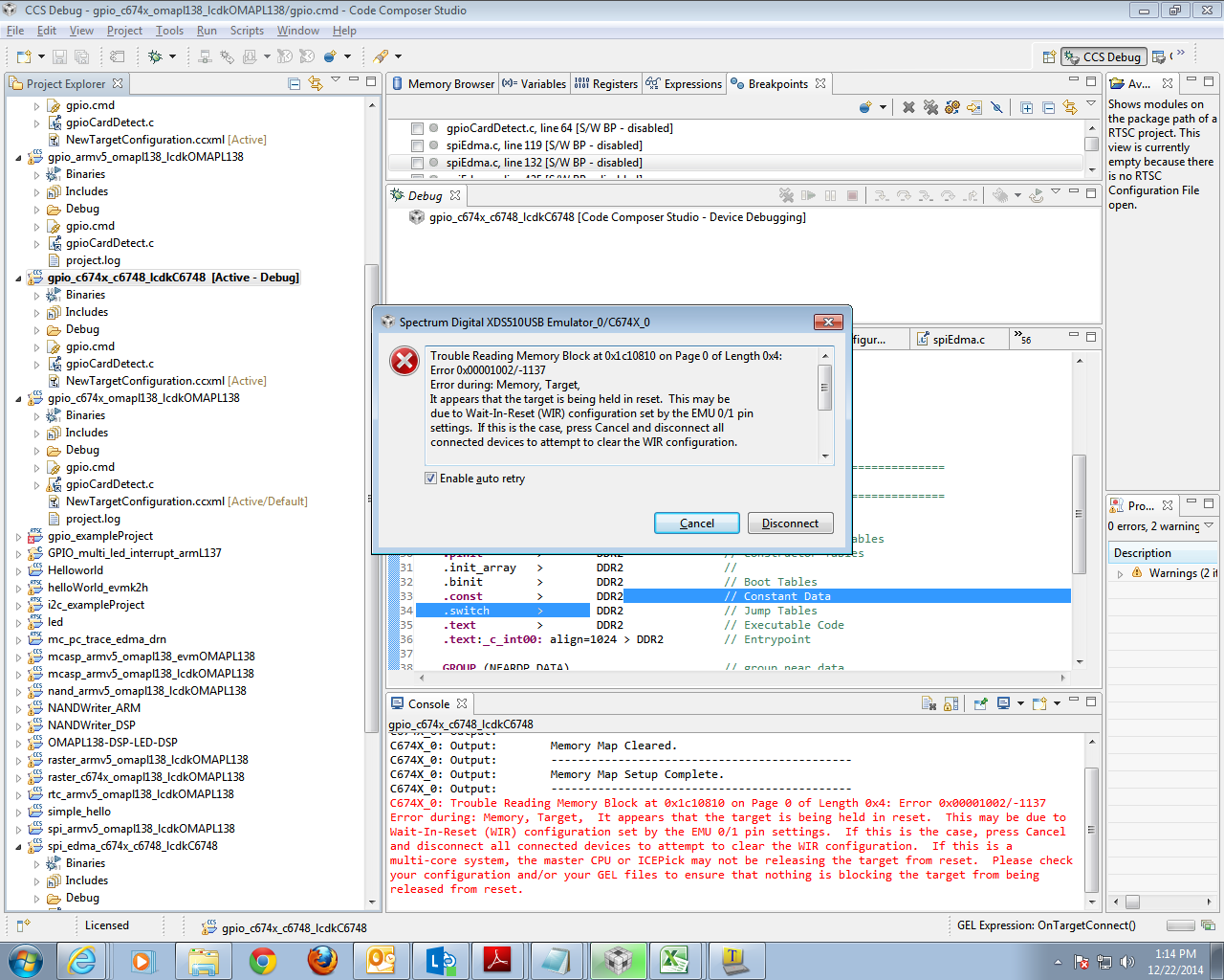

    Do you get error something like this on the CCS?
    1. if you are running the souce code created for C6748 core to run on C6748 LCDK board  and running on OMAPL138 board, you are likely to get this error and do the reset. For example, the name of the source code itself indicates, "gpio_c674x_c6748_lcdkC6748" . Go to project properties and check the family and variant under CCS General.
    2.  Open *.ccxml, go and check which gel file is loaded? under "advanced--> C674x_0 and ARM9_0 --> bypassed???
    The reason for the required reset is OMAPL138 is a ARM bootable device, ARM core will wake up first which in turn will wake up the DSP core. If it is a code intended to run on DSP core and the DSP core is not yet wake up by that time, there is a possibility of this error.
