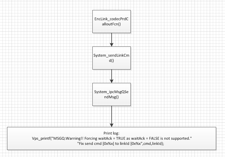

   This morning I discover a issue,the M3Video cpu report a asesert,then whole program hang.
   this issue happen when run 4 days
   log msg:
 [m3video] MSGQ:Warning!! Forcing waitAck = TRUE as waitAck = FALSE is not supported.Fix send cmd [0x6000] to linkId [0x10000023
 [m3video] !!!XDC RUNTIME ASSERT FAILED
 [m3video] xdc.runtime.Error @ ti.sysbios.knl.Semaphore: line 204:
 [m3video] assertion failure: A_badContext: bad calling context. Must be called from a Task.
my link chain:
thanks Very much!
  • Hi:
       I see the RDK src code,I found this log:
    from this log can know:
    link: Enc
    cmd:ENC_LINK_CMD_GET_PROCESSED_DATA
    function call sequence:
    but from the src code ,enc link impossible call System_ipcMsgQSendMsg()for cmd
    ENC_LINK_CMD_GET_PROCESSED_DATA, it should call System_sendLinkCmd_local()
    so this let me feel confused
    wish some advice to solve this issue!
