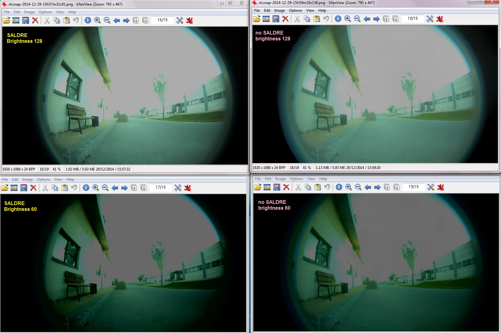

  • Hello Anand,
    I really appreciate your explanations.
    I went back to the original tri-stream full-feature usecase, 1920x1080. I did a NAND-scrub and burned the UBI_FileSystem, uImage, and uBoot files. Without SALDRE and also with SALDRE, here is the a frame captured from the camera. Attached is also a frame from my smartPhone - so you can see the way colors should be. TI's 2A engine - AutoExposure was set with average brightness at 60. AutoWhiteBalance gives worse colors, so it was disabled.
    Our camera will have to work in bright sunlight, dusk, rain, etc. We must be able to work with all types of lighting conditions.
    Here's the "real" colors:
    The image captured from the DM8127 IPNC is of resolution 1920x1080 with AWB disabled right?
    regards,Anand
  • Correct - 1920x1080 with AEC and without AWB
  • Hi Anand'
    I think I may have figured out why this "pink" problem occurs.
    I wasn't using the original uImage when I took the previous pictures. I replaced with the original uImage, and the pictures were closer to the real color.
    Then I put on the fish-eye lens that I will be using for the final camera, and without changing to the 1200x1200 driver, I got pictures with much pink. I think that since the camera "sees" alot of black on the sides of the actual picture, it tries to compensate and therefore the gains are raised - causing the pink. It would be nice to be able to define an ROI for the AEWB... But when I use my driver of 1200x1200, still I get the pink - which means that the AEWB is still taking into account all of the black surrounding area.
    Below is from my smartPhone - the "real" colors (though the sky should be a bit bluer):
    Here's the picture using the fish-eye lens with default usecase 1920x1080. I tried with/without SALDRE and lowering the brightness, which didn't help - since it's trying to compensate for the black areas.

    I thought that since the driver is 1200x1200, the black areas are much smaller and the picture would be better.
    Video clip has 2 scenes which are shown in attached pictures.
    First can you make sure you get the 1080p use case working w.r.t AEWB?
    I have tested the 1080p use case with Fish eye lens in the outdoor condition and AEWB is working fine.
    Pl. find the snapshot attached.

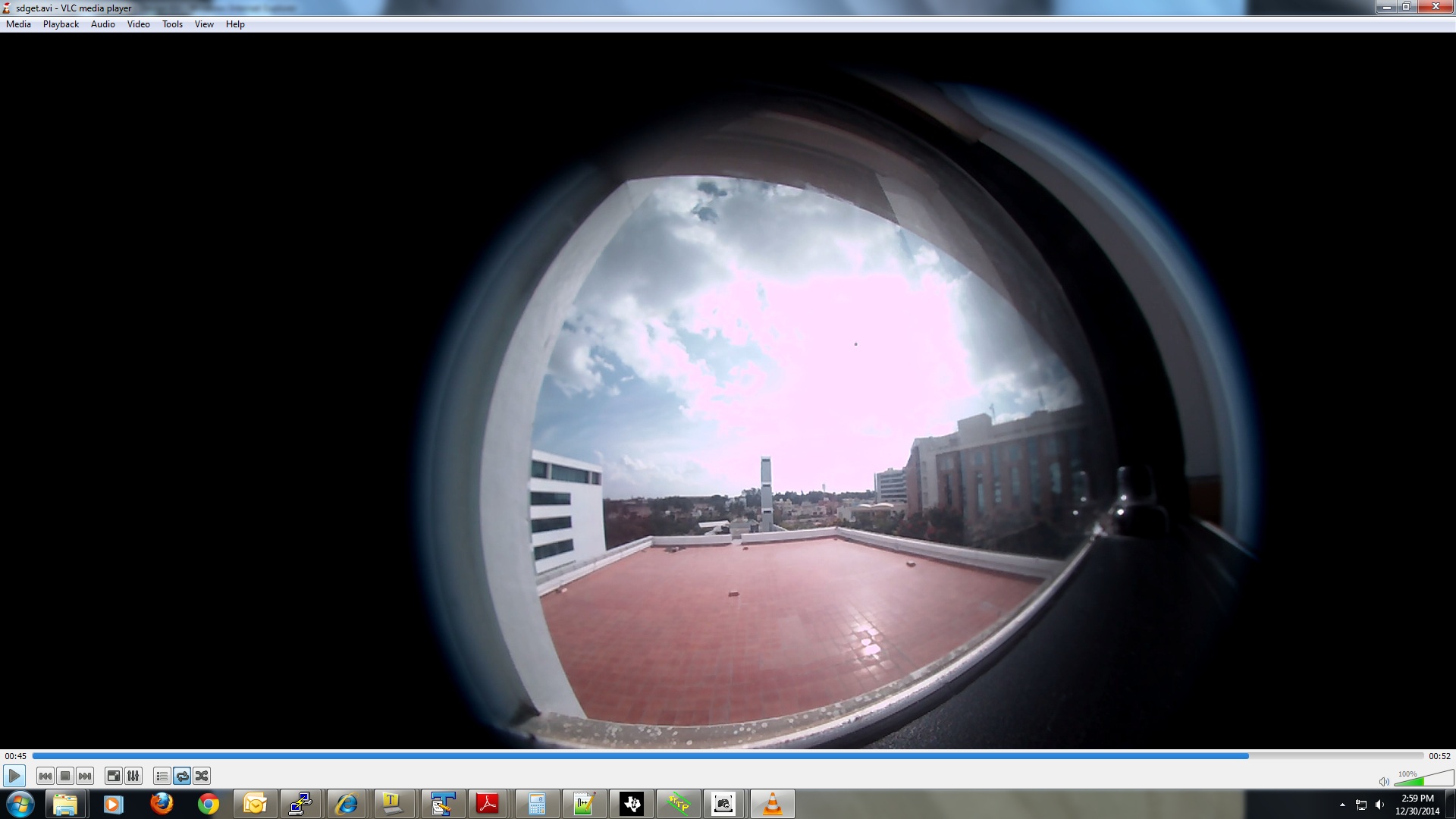

  • From my experience, the pink color comes from the IR present in sunlight when filming outside. Lowering exposure value and closing the IRIS helps avoid it somewhat but the real solution is to use an IR-cut filter (which is most likely used in the cellphone camera).
  • I will definitely try that - I'm sure it will make a difference. The lens we're currently using has an IR filter - but I will try to use a stronger IR filter.

  • Hello Anand,
    I did exactly what you suggested (burning the original, default usecase into the NAND) and the results are in the post from Dec 29, 2014 11:57 AM. I did a NAND scrub and put in the original filesystem. I did it again yesterday with the same results.
    The SALDRE gives me black/white screens overlaying the original frames - how is this to be stopped? It happened in the default usecase on the NAND.
  • As far as the shot you sent me, with which camera was this picture taken? I don't think you were standing outside, rather taking the picture from a window of a building.
    What were the AEWB settings and SALDRE settings?
    All of the outdoor pictures that I've sent were taken outside - such is the camera we're building - it will have to be outside in all weather conditions working 24/7.
    We are using the red APPRO camera evaluation for the DM8127. I'm wondering if there's a "leak" of light or reflection of extra light that is causing the unnatural colors I've been seeing.
    We tried doubling up the IR filter - but no change - picture still shows abnormal amount of pink in all over saturated areas.
