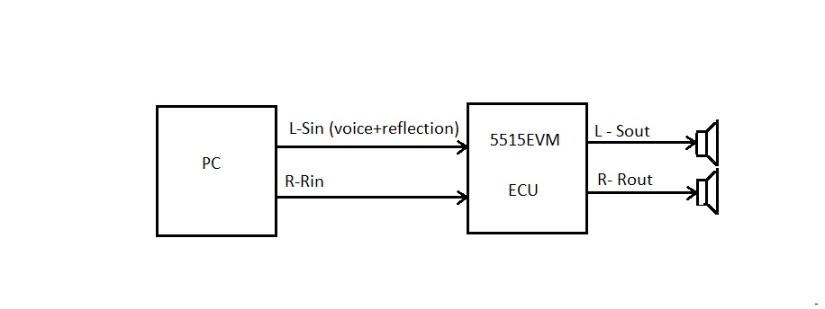

I am trying to get ECU worked but it always stop cancelling echo after 30 - 60 second. For testing purposes I am using ECU demo tracks(Sin and Rin) which come from PC to the board. Frames are synchronized and there is no delay between them.
Within 30-60 sec it is working well, even better than I expected but after that time Sout is just a copy of Sin.

  • Hi Stan,
    It is true that the BG, FG and SEARCH buffers are updated by ECU, and not expected to have ecuControl function to clear these buffers . In the case that if echo has been successfully cancelled for 30-60 seconds, the ECU initialiation and control bits in ecuControl seems have been setup properly. Have you verified the lower layer PCM data driver of receiving/sending data, i.e. if you diable ECU, are you always able to get Sout/Rout as Sin/Rin? There are a lot of buffer allocation discussion in the thread http://e2e.ti.com/support/embedded/tirtos/f/355/t/299040#pi239031349=2 : ECU (VoLIB 2.1.0.1) crashes when running on multiple channels in real time, but root cause was DMA/MCSBSP configuration. Also, is echo path changed in the Rin/Sin signal after 30-60 seconds? The Rin/Sin in the VoLIB is 15 seconds only, can you post your Rin/Sin and Rout/Sout signals here captured on EVM?
    Regards, Garrett
  • Hi Garrett,
    Thanks for your reply.

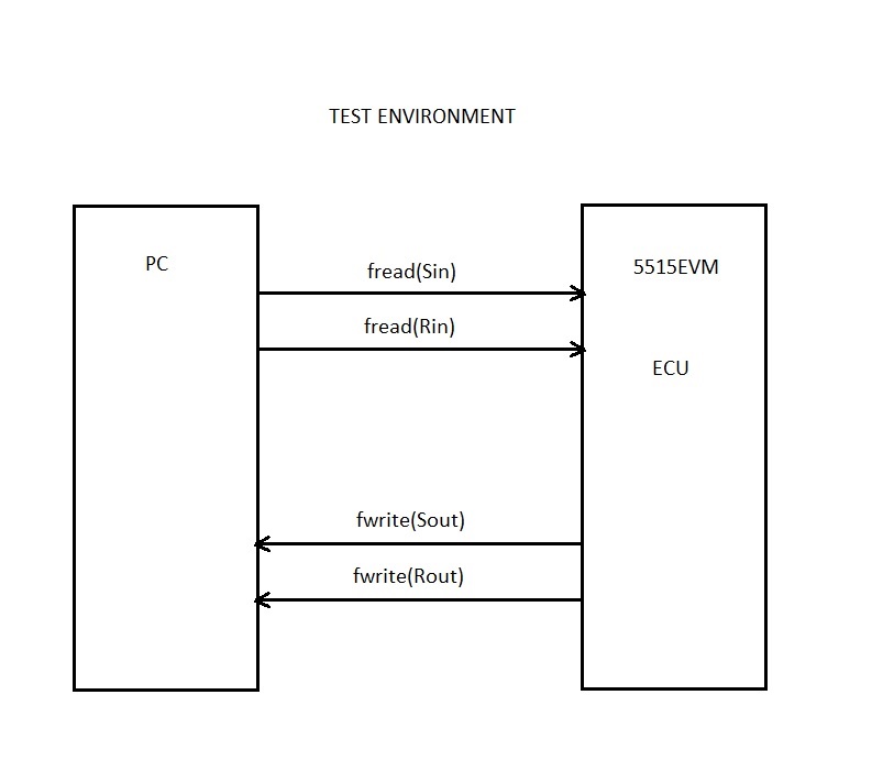

    Ans. Yes. When I disable ECU and use memcpy to copy signal  from Sin to Sout and from Rin to Rout I can hear music, voice or DTMF tones without being corrupted.
    Ans. No. All pachs are always the same. See picture. I am using audio files which were provided with demo.
    Can you post your Rin/Sin and Rout/Sout signals here captured on EVM?
    Ans. Will do.
    I changed the code trying to reproduce ECU performance like in demo. So C-file is attached.

    Currently I have two difficulties:
    1. ECU still does not work without ecuControl calling every time after ecuSendIn.
    2. ECU works only if voice is 12dB higher than reflection in Sin signal. While in demo 6dB is enough to have pure voice without reflection.
  • The audio file I am using.
    Fs-8000Hz,  Res-16bit, u-Law. PC provides linSample for both LEFT(Sin) and RIGHT(Rin) channels
    ECU_test_audio.zip
  • Stan,

  • Garrett,
    The test project is ready.
    1. Lets set up a target. I would like to have the same result as in the ECU demo project, sin/rin and sout/rout attached. It is Fs-8kHz, Res-16bit, u-law.
    ECU_demo_results.zip
    2. My test environment:
    3. Results (all files Fs-8kHz, Res-16bit, A-law):
       Sout/Rout with 15 seconds demo Rin/Sin PCM samples.
    5515evm_15sec_alaw.zip
    Sout/Rout with 90 seconds Rin/Sin PCM samples.
    5515evm_90sec_alaw.zip
    4. Test project and also c-file just for the convenience (everything was done according to your recommendation):
    ECU_PC.zip

    tsize i,j, frame_count, progress_count, progress_sec;
    int main(void)
    	printf("ECU START SIMULATION\n");
    	ecu_init();
    	/* Open and prepare files */
    	strcpy (fstring_sin, FILE_OUTDIR);
    	strcat (fstring_sin, filename_sin);
    	if((file_sin = fopen (fstring_sin, "rb")) == NULL)
    		printf("Error in opening file sin.\n");
    		exit(1);
    	strcpy (fstring_rin, FILE_OUTDIR);
    	strcat (fstring_rin, filename_rin);
    	if((file_rin = fopen (fstring_rin, "rb")) == NULL)
    		printf("Error in opening file rin.\n");
    		exit(1);
    	strcpy (fstring_sout, FILE_OUTDIR);
    	strcat (fstring_sout, filename_sout);
    	if((file_sout = fopen (fstring_sout, "w")) == NULL)
    		printf("Error in opening file sout.\n");
    		exit(1);
    	strcpy (fstring_rout, FILE_OUTDIR);
    	strcat (fstring_rout, filename_rout);
    	if((file_rout = fopen (fstring_rout, "w")) == NULL)
    		printf("Error in opening file rout.\n");
    		exit(1);
    	printf("Files are opened\n");
    	progress_count = 0;
    	progress_sec   = 0;
    	// FRAMEWORKS and ECU
    	for(frame_count = 0; frame_count < N_frames; frame_count++)		// file is 15sec duration, Frame is 10mS.
    																	// N of frames = duration(sec)/Frame(sec)
    		fread (scompr, 1, FRAME_SIZE, file_sin); 					// read 1 frame
    		fread (rcompr, 1, FRAME_SIZE, file_rin); 					// read 1 frame
    		pcmAlawDecoder(scompr, sin, FRAME_SIZE);					// SIN expand a-law frame to linSample
    		pcmAlawDecoder(rcompr, rin, FRAME_SIZE);					// RIN expand a-law frame to linSample
    //  					ABOVE  this line Sin and Rin are linSample
    	    /* Compress A-law delay line samples */
    	    muaTblAlawCmpr (FRAME_SIZE, rin, rinCompr);
    		/* Pack samples for delay line compression */
    		for (i=0; i<FRAME_SIZE; i++)
    			rcompr[i] = rinCompr[i] & 0xFF;
    		ecuSendIn(ecu_inst.ecu_Inst, sin, rcompr, sout);
    		pcmAlawEncoder(sout, scompr, FRAME_SIZE);					// Compressing to a-law
    		fwrite ((void *) scompr, 1, FRAME_SIZE, file_sout); 		// Write frame to the file
    		fwrite ((void *) rcompr, 1, FRAME_SIZE, file_rout); 		// Write frame to the file
    		if(++progress_count == 100)
    			progress_sec++;
    			printf("Progress: %d seconds\n", progress_sec);
    			progress_count = 0;
    	fclose(file_sin);
    	fclose(file_rin);
    	fclose(file_sout);
    	fclose(file_rout);
    	printf("Files are closed\n");
    	while(1);
    All Sin and Rin are identical except duration.
    As you can see from 90 sec sout-file one problem has gone. I do not need to call ecuControl every coming frame to get ECU worked. I can accept that something is wrong with DMA ping-pong mode in my main project. But still there is a reflection within the voice part. However, I do not see this echo in demo Sout. Moreover, ECU is cutting even a speech in my sout-files but in demo everything is perfect.
    Questions:
    1. Why adaptive filter does not work in my test project?
    2. Why there is not enough SNR for ECU in my case that causes cutting the speech, but demo works well?
    PS: Sorry for demo files saved in u-law. It seems like demo does not work with a-law. I changes with
      ecuSim->pcm_format  = const_COMP_ALAW_8;               /* u-law is default companding law */
      ecuSim->frame_size        = 10*8;                        /* 10ms default frame duration */                    // The same for u-law
      ecuSim->ecu_y2x_delay     = 10*8;                        /* One frame default y2x delay */               // The same for u-law
    but sout is really weird. If it helps I can upload these out-files too.
    Thank you.
    Stan

  • * ECU TEST PROJECT
    * This project was designed to simplify ECU demo from VOLIB package
    * and check ECU performance. In some cases code is obvious and there
    * are some non-optimized functions and extra steps which make this
    * example is easy to follow and understand. The results are absolutely
    * the same as in ECU demo.
    * Test environment:
    * Picture with test environment is in the folder with audio files
    * #define FILE_OUTDIR "c:/ti_projects/ECU_FROM_PC/vectors/"- just
    * make sure you have the same path or change it on your own preference
    * In general, the project can be run to any platform (checked on C55xx)
    * because there is no any hardware dependencies. All files are being
    * read and written by fread and fwrite functions.
    * **NOTE**: you have to check data types. In my case(C55xx):
    * tint - int (16bit)
    * tword - unsigned int (16bit)
    * **IMPORTANT**: Audio files are in A-law format (It is Fs-8000Hz, Res-16bit, A-law).
    ECU_FRAMEWORK.zip
    Enjoy)
