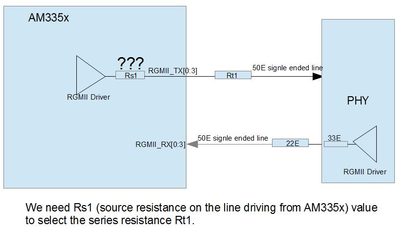

Please let us know the driver output impedance of the RGMII_1 and RGMII_2 signals from the AM335x to provide the series termination on these pins.

Hi Biser,
Normally PHY chip manufacturers provide only the source termination resistor values (for the RGMII_RX pins from PHY chip) as per the driver ability of the PHY chip. They wont usually give the termination resistors values in the transmitter side (AM335x/Processor side).
So kindly let us know the driver output impedance of the AM335x RGMII Tx pin pad's.

Feedback from the factory team: This information is contained as part of the IBIS model.
What information is available has already been posted on this thread. You can also use AM335X design files as a reference: http://processors.wiki.ti.com/index.php/AM335xBoards
I think I already explained that the I/O buffer drives 50 Ohm. No serial resistors are necessary for the TX lines if the PCB traces are routed as 50 Ohm single-ended impedance lines. See also http://processors.wiki.ti.com/index.php/AM335x_Schematic_Checklist#Ethernet
