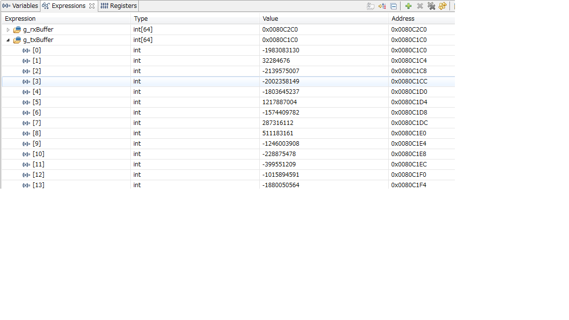

When the control reaches to "nop", I think the transfer should happen, but actually,no transfer.
Do you have any suggestions ? Please note tx/rx buffer has been allocated in L2RAM. So, I don't implement cache related code to tx/rx buffer.
What I want to check with this code is to evaluate the latency in uPP. So,I'm doing only minimal configurations to uPP.

    Unfortunately, I've been getting stuck yet.
    I found one mistake in the above code. I accessed PIN_CONTROL_1 register by using CSL, but the address of bootRegs->CHIP_PIN_CONTROL_1 was incorrect, i.e., it was *not* 0x02620584 ! I believe the definition of CSL_BootcfgRegs structure is incorrect. So, I changed my code as below. Also, I've done the minimal changes about UPP configurations:

    With this code, uPP started to work, but its behavior is *very* strange! i.e., when the control went to "nop" in the above code, the contents of tx buffer was clashed .
    Please note g_txBuffer has been initialized correctly before starting uPP.
    Here is a snap shot. As you see, g_txBuffer is being clashed.
    At this point, UPISR (0x02580020) indicated 0x00000018 (End of line/window events detected). So this means the transfer has been completed, but something incorrect data have been routed to g_txBuffer, rather than g_rxBuffer. Also, after EVM power cycle, I inverted the polarity of CLOCK_B (uncomment the code : (CSL_UPP_UPICR_CLKINVB_INVERT << CSL_UPP_UPICR_CLKINVB_SHIFT) | //Falling edge to send data), and then this issue did not happen, but the g_txBuffer was not transferred to g_rxBuffer.
    I'm concerned if uPP is really available on this device... Can you check this issue at your end ? I believe you can recreate the issue easily.

    I don't really understand why g_txBuffer is routed to g_txBuffer (with clashed data), rather than g_rxBuffer.....

    We tried re-producing the issue. The Tx buffer is not over written. We think, the issue may be with memory configuration(.cmd). Could you please share the complete project?

    Now I noticed .upp_buffer section is allocated doubly. Sorry this is just my typo, but I confirmed g_txBuffer and g_rxBuffer are allocated to L2SRAM with separate address. Please find *.map file. So this should not be a matter.
    0080c1c0 g_txBuffer
    0080c2c0 g_rxBuffer

    I checked the gel file and I noticed boot config register should be accessed via lock/unlock mechanism.
    And I just add this to my code and confirmed my code worked. I'll post the complete code here later.
    kawada
  • Hi
    Here is a complete code.
    5700.sample_c6657_upp_loopback.zip
    With this code, I verified uPP loopback on c6657 EVM.
    As I mentioned in the previous post, the problem was not uPP register configurations, but no configuration of KICK0/1 registers.
    (I don't know why I could see txbuffer-overwrite without the configurations of KICK0/1 registers, but now this is not a matter with me)
