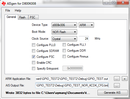

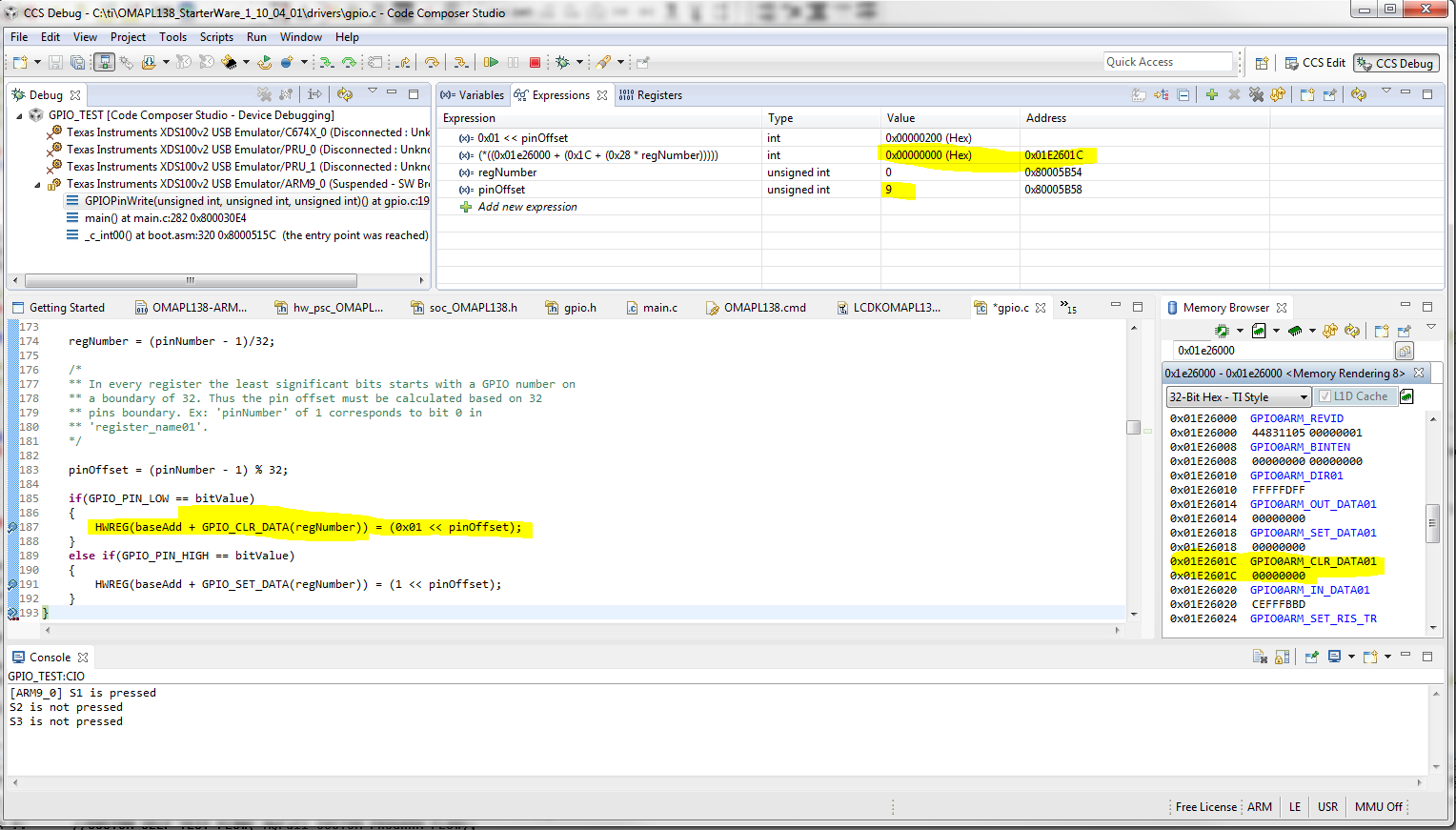

  • Hi TI team,
    Now we could have the "Identify Device command" (in addition to spin up ) working correctly on our custom board.
    Next we need to test the ARM booting from SPI flash.
    Can you please provide an example CCS6 project that we can use for testing flashing LED to any GPIO pin (we have access to GP0_0 to GPO_10).
    Can also please please provide the image that can be loaded directly to the SPI flash for the same above purpose.
    Please note that:
    * The available examples in the WIKI here are only for other custom EVM which use I2C (we don't have access to that)
    * We have direct access to the flash so we can download the image that you will send us directly to the flash SPI without the need to an additional utility.
    Ayman
  • Hi again,
    Just for clarification, we need a CC6 simple executable ARM blinky LED to test the OMAP-L138 GPIO functionality on our board (we don't have port expander and we want to directly access the GPIO pins).
    We appreciate if you can send us a tested project which has all needed initialization.
    Ayman

    I still see issues though.  Although the pins that are configured as input give me the right behavior, those which are configured as output (pins connected to LEDs) are not.
    They all are always on. Bits in the The CLR registers are never set (what ever I tried to write to them), please see the attached sceenshot (although the expression in the RHS gave 0x200 the CLR register still has "0x00".
    Any thought about the reason for that.
    Ayman

  • Hi Titus,
    I am trying to execute the GPIO test example from the starterware (attached) for the OMAP-1368 LCDK, this is example we were discussing in the above posts.
    This example sets 4 pins as input (these are connected to 4 DIP switches), these pin behave as expected as I could read the correct status.
    The example also sets another 4 pins as output (these are connected to 4 LEDS on the LCDK).  These are not behaving in the expected way and they are always high regardless of the settings of the clear and set registers.
    Please have a look and let me what is wrong here.

    I'm able to reproduce and found the problem.
    Actually this code written by me and tested one too, I wrote this for one customer, so I've given to you directly.
    We have to copy this code to your in any ARM starterware code, so you would get all the libraries and everything.
    If you look into any ARM starterware example code, you could see all the required library and different *.cmd file.
    You have to use the following linker command file into your project to run this code without any problem.
    C:\ti\OMAPL138_StarterWare_1_10_04_01\build\armv5\cgt_ccs\omapl138\lcdkOMAPL138\gpio\gpio.cmd
    Your code seems to be created new project and not used the "system_config.lib", this library is responsible to enable the "SYSCONFIG" register access and unlocking the KICK registers etc.,
    So, I would like you to suggest to link the "system_config" library into your project and starterware ARM's example linker command file and rebuild your project  then this code work as you expected.
    Please let me know the status.
    I am sure that this would fix this problem.
  • Hi Titus
    I added the mentioned library and the cmd file and still seeing the same behavior (see attached screeshot).
    4667.GPIO_TEST.zip
    Not able to see the LED blinking while you change DIP switch state?
    Copy your complete code and put into the following file and import this project.
    Source code location:
    C:\ti\OMAPL138_StarterWare_1_10_04_01\examples\lcdkOMAPL138\gpio\gpioCardDetect.c
    Import location:
    Able to see the updated value PINMUX registers in CCS's "Register window" ?
  • Hi Titus,
    I tried the project you mentioned with the source file "gpioCardDetect.c" and it worked fine (I could see the LED blinking).
    I went ahead and commented the code in the main function in my project and pasted the code in the main function of the above file, it worked as well.
    So I guess these is something wrong in the main function of the example that read the switches and output the status in the LEDs.
    Can you you please have another look and let me know what is wrong there.
    Meanwhile I will try to test the same project on our HW. Also I will try creating a boot image and see if I can boot the omap from that.
    Ayman
    Actually I've used your GPIO_TEST code only with "system_config.lib" issue fix and able to run without any issues.
    Don't know what you have changed on your project, that's why I have suggested to use the ARM starterware example code template with linker command file to isolate the problem.
    FYI: I'm able to run your GPIO_TEST project (LED blinking and switch interrupt) after used the proper "system_config.lib"
    I would like you to suggest to compare the both working and non-working CCS properties of "Linker" option and linker command (*.cmd) of the project.

  • Hi Titus,
    Looks like the PINMUX(9) did not get updated when I tried to write any value to it (Please look at the attached sceenshot).
    Also I think PINMUX retain its value after power cycle, so if please make sure you can reset it to zero before you try my attached project.
    GPIO_TEST2.zip
    I'm able to see the updated PINMUX9 value (0x80000000).
    In your project, you have disabled the "gpio.cmd" linker command file which is required for SYSCFG registers (PINMUX) access.
    I told you already that we have to use "system_config.lib" to unlock the SYSCFG registers like PINMUX, you have to use "gpio.cmd" file to utilize the "system_config.lib", you may linked this library but "gpio.cmd" file would use, check the below lines.
    gpio.cmd

  • Hi Titus,
    Normally I use the "AISgen_d800k008.exe" to convert .out to .bin which should be downloaded to the SPI flash for booting.
    Can you please advise how can I use the .cfg file here?
    Please also note that my example does not use the DSP, it used the ARM core.

  • Hi Titus,
    I have tried the cfg file you sent withe AISgen tool to boot from flash on the LCDK and here is my observations:
    1- The boot mode in the AISgen tool changed to NOR (I don't think that the LCDK has NOR chip)???
    2- The SFH tool never end when I tired to flash the bin file.
    Please see the below screenshots.
  • Hi Titus,
    I changed the target to NAND in the AISgen and the sfh tools and successfully downloaded the code to the LCDK and it worked.

    I given the *.cfg file for all the boot modes, NOR,SPI,NAND so, just import that file and change to SPI0 or SPI1 flash as per your custom board design then convert.
    Also, please make sure that you have given proper SPI clock in its "Peripheral" tab and ensure that you have given GPIO PSC module no and required PSC listed in "Enable PSC" of "PSC" tab after you ticked "Configure PSC"
