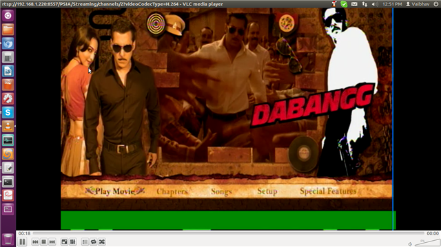

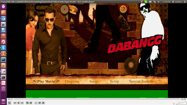

We are using DM365 EVM wtih IPNC RDK.We are running the demo application"av_server.out" given in IPNC rdk only.
It is working fine. But when I disable Resizer in code by setting config->captureSingleResize   = FALSE;, I got a blue vertical line on right side of video.
Please find attached both of the snapshot
1] Resizer Enabled
2] Resizer Disabled
Why this blue line on right side of video is coming?? We are capturing video via composite connector to tvp5145 to vpfe to dei to resizer.
