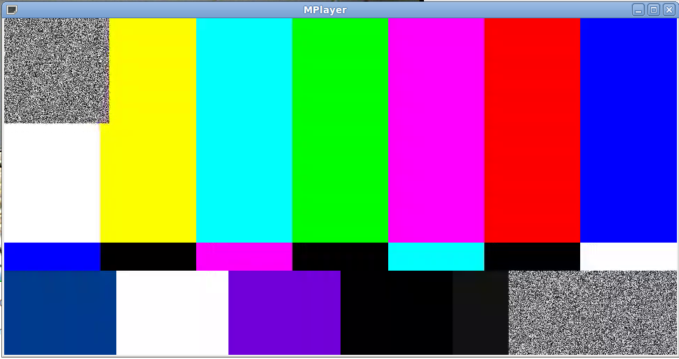

    I am able to encode 2  videos . Here is my pipeline.
    gst-launch -e videotestsrc pattern="snow" ! 'video/x-raw-yuv,width=150,height=150' ! videomixer name=mix !  ffmpegcolorspace ! omx_h264enc ! h264parse ! filesink location=1.264 videotestsrc ! 'video/x-raw-yuv,width=960,height=480' ! mix.
    Here is the output:
    Margarita
