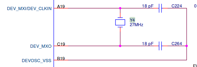

Hello;
I am looking for the transconductance value of the crystal amplifier circuit for the TMS320DM8168 chip.  It is represented by gm and the units are mA/V.  It is not in the datasheet.  It is the crystal amplifier circuit off pins A19 (DEV_CLKIN) and C19 (DEV_MXO).  Any assistance would be appreciated.

  • Hello Pavel,
    I would completely agree with your response, IF I was selecting an external crystal.  But I am not, I have a customer who is using the DM816x chip and is having intermitten problems with start-up.  We are reviewing the crystal drive circuit.  I have completed a Negative Resistance and Drive Level test in efforts to trouble-shoot the problem.  A different approach is to use a calculation finding Gm Critical and in this calculation it uses the trans-conductance of the Amplifier or driver circuit (this is within the DM816x IC).  This information has to come from the manufacture of the IC, (TI).  TI either will or will not give me this information. Other IC manufactures do offer this information, I'm just asking if TI will do the same.

  • Pavel,
    I know the crystal external, BUT inside the IC between pins A19 and C19 is an amplifier, (this may be what your calling the internal oscillator), something has to provide power to  the crystal, and that power exits and enters the DM816x through these two pins (A19 and C19).  The IC circuity (amplifier or oscillator) that provides this power has a trans-conductance value, that is the value that I need for my calculation.  I don't need assistance in choosing a crystal, I know the crystal is external.  Crystals are passive components, they need a power source and that power source comes from the IC.

  • James,
    I have checked with the HW team, but I was not able to find this info.
    Pavel
