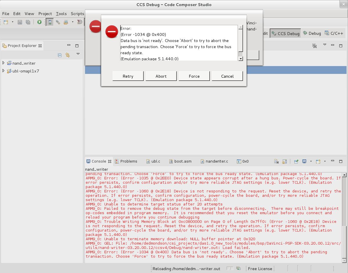

While adding some POST testing to the UBL code we introduced an exception very early in the boot process from NAND. Once the exception occurs I cannot access memory and cannot load nandwriter to recover this board. I believe the correct thing to do is to get the GEL file to correct the error condition. So far I have not been able to get the GEL loaded.
If I hit the reset button, the buggy code runs again before I can connect the debugger and so the exception gets re-introduced. I'm looking for a technique. :-)

  • Hi Ki,
    I was loosing CCS connection but I found the button to keep debug going even if the program load fails. Here is a screen shot of where I get stuck. I have tried Abort and Force several times but you can see from the console output it hasn't been successful. This exception happens so early I haven't been able to get between the reset and the line of code causing this. I'm thinking I may need to change the boot target strapping so that it doesn't look to NAND and then would not crash. Make it look like board that hasn't been flashed at all.

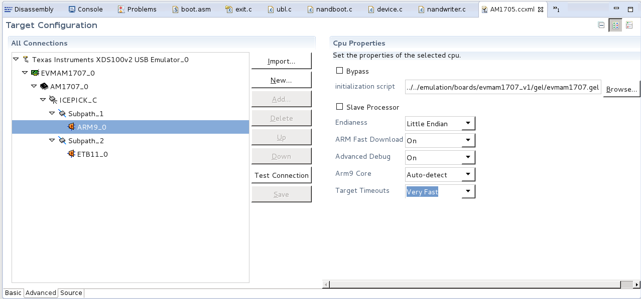

    Thanks for re-posting this. I need to follow up and let you know that I did stumble upon recovering the board. I had stopped using the GEL file since our boards are all booting and being configured by boot code. Long story short, once I re-discovered the right place to configure the target configuration to use the GEL again the recovery went just like I expected. Maybe the experts in the other forum can spot something else I missing.
    Once the code had hit the exception, I could reset the processor with the emulator attached, then I could see the GEL played in the console. Once that happened the data bus hang was corrected and I could re-flash the board.
  • oh right! If you have target initialization done by some boot loader and then you launch the debugger with a target config that uses a startup GEL file that also does target initialization (holy run-on sentence batman!), then you would blow away the previous initialization and put the target in a bad state. Good catch!
