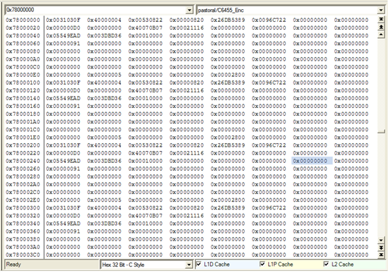

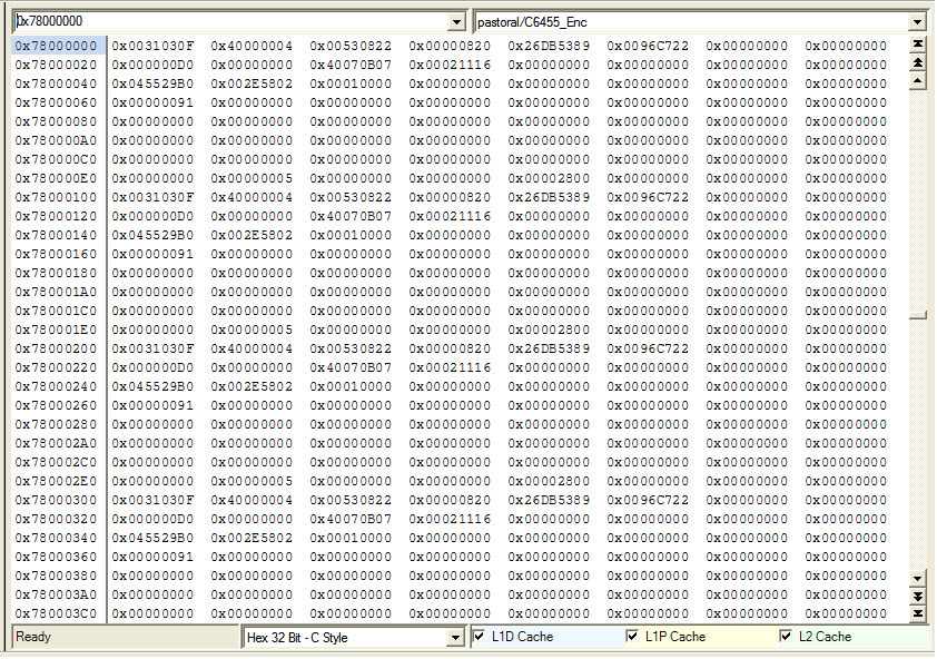

    I ran a memory test on L1RAM and L2RAM   ( The test program was loaded in DDR2,  L1P was enabled, Data Caches disabled ).
    We got memory errors (stuck bit ) on memory location in L1D  and L2 RAM.
    Has anyone ever come across internal memory errors on the C64+ DSPs ?
  • It would be good to take DDR completely out of the picture. Your test program is probably less than 32KB, and if not, find a way to shrink it to less than 32KB. This way it will fit completely into L1P and everything can be contained within the C6455.
    Disable all cache, including L1P, and load the test program into L1P and run it from there.
    From what you have said above, you will find stuck bit failures in L1D and L2. Is this true on all 4 failing boards, that you have stuck bit failures in both L1D and L2 on all 4 boards?
    What patterns, if any, show up in the 4 sets of failure signatures?
    Do the same bits fail every time?
    Do they continue to fail until reset is applied?
    If you apply reset after power cycling, do the failures go away?
    Are the failures temperature or voltage or CPU frequency dependent?
    After you have exhausted all electrical and environmental tests, have you tried swapping the DSPs between a working board and a failing board to confirm that the failures follow the DSP and not the board, or go away when moved to a new board? I do not know if this is a practical thing for you to do or not, but some customers do this to try to prove whether the problem is with the DSP or the board/components.

    No pattern , the error is in L1D on 2 of the boards and L2 on the other two.
    Yes, for each of the faulty DSP,  same bit and same location fails, But  the bit and location are different among the 4 DSPs

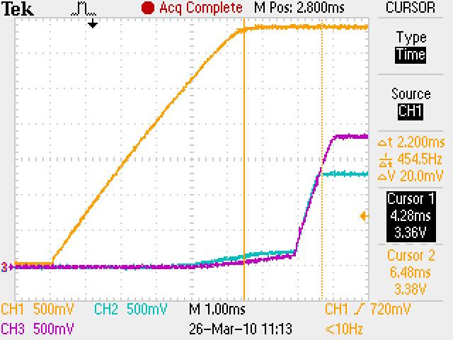

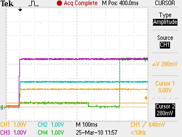

  • Tim,

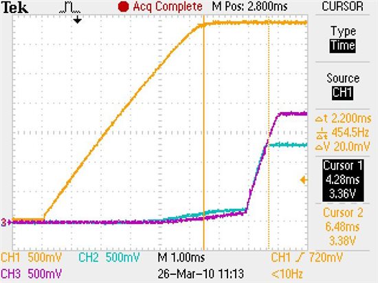

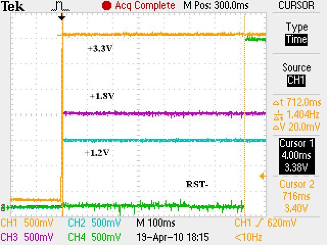

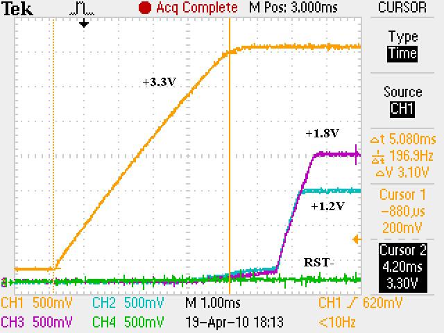

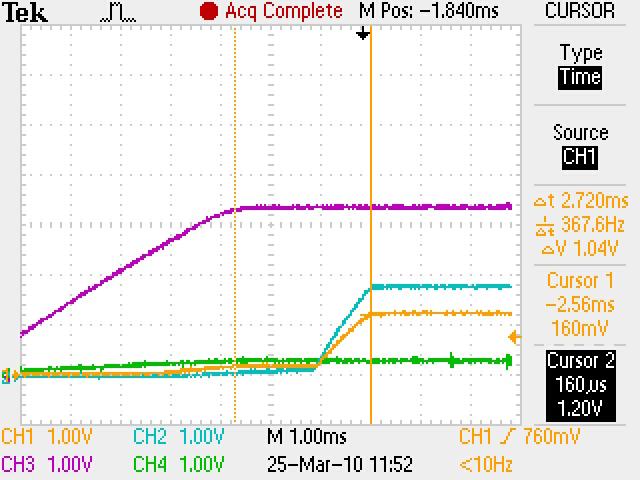

    Here are the power and reset timings.
    This is the reset timing its around 700ms after the voltage is stable. ( reset is the green signal )
    The only  anomaly I can see is that the reset signal is around 280mV when the power is coming up.
    This is the power up sequence 3.3 first and 1.8 and 1.2  2.7 ms later
  • According to the data sheet:
    "After the DVDD33 supply is stable, the remaining power supplies can be powered up at the same time as CVDD as long as their supply voltage never exceeds the CVDD voltage during powerup."
    It looks like your 1.8V rail is higher than the 1.2V rail for pretty much the entire period.  That might be the issue.

    I shall look into the 1.8V rail being higher than the 1.2 . Thanks for your reply.
  • Brad,
    We fixed the 1.8 V rail being higher than the 1.2V rail but still no joy.
  • So if you just power up your board and immediately give it a reset before running any tests/code do you avoid this condition altogether?  What does your reset timing look like?  Perhaps there's an issue there.
    I often like to go through the data sheet searching for the word "must" because a lot of important info tends to follow in general.  Make sure you don't have any reserved pins terminated incorrectly, etc.
  • We have checked the reset timing and reserved pins and they all seem correct. We have had boards manufactured with this design work fine for over two years now but just encountered 4/150 boards with this problem.

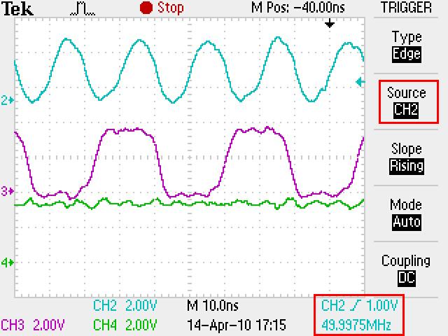

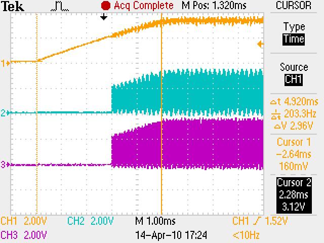

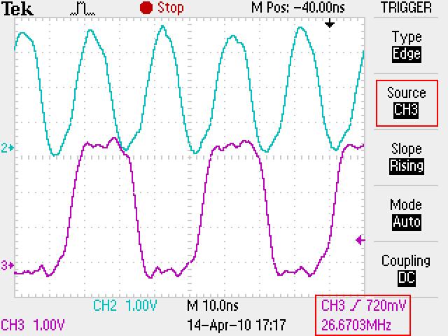

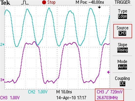

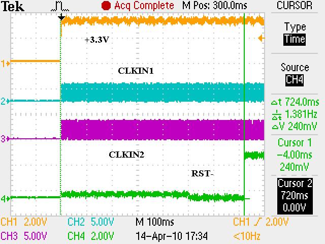

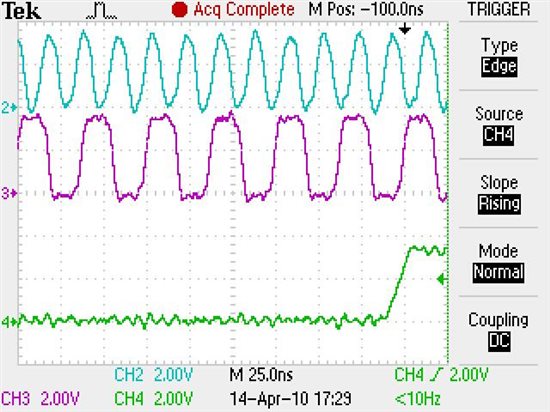

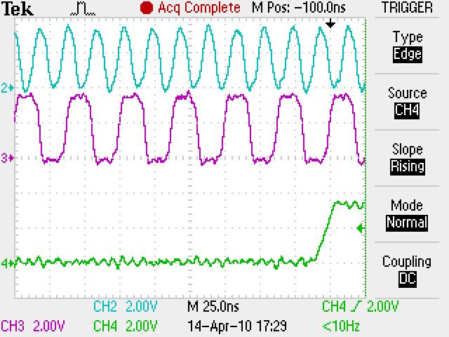

  • What speeds are CLKIN1 and CLKIN2?  Are they stable?  After your voltages are stable you must make sure that nPOR stays asserted for at least 256 CLKIN2 cycles.
    Is there an easy way for you to lengthen the delay until reset is released?
    CLKIN1 is 50MHz  . PLLM is (20-1) and the DSP Freq is 1000MHz
    CLKIN2 is 26.6 MHz
    As seen the in scope trace here, the reset is deasserted 700ms (which way over the required 256CLKIN2 cycles) after the voltages are stable.
  • I've not seen CLKIN1 and CLKIN2 anywhere.  Can you please check to be certain they are stable long before reset is released?  A couple screenshots would be great.
    Here are some more scope caputres:
    Voltages :  3.3V comes up first, 1.2V and 1.8V come up  2ms after 3.3V is stable.
    Reset  is de-asserted 700ms after the voltages are stable:
    Clocks:
    CLKIN1 is 50MHz
    CLKIN2 is 26.67 MHz:
    The Clocks start when 3.3 V  comes up:
    Both the clocks are stable when RST goes high ( 700ms after voltages are stable) :
    Let me know if you need more information.

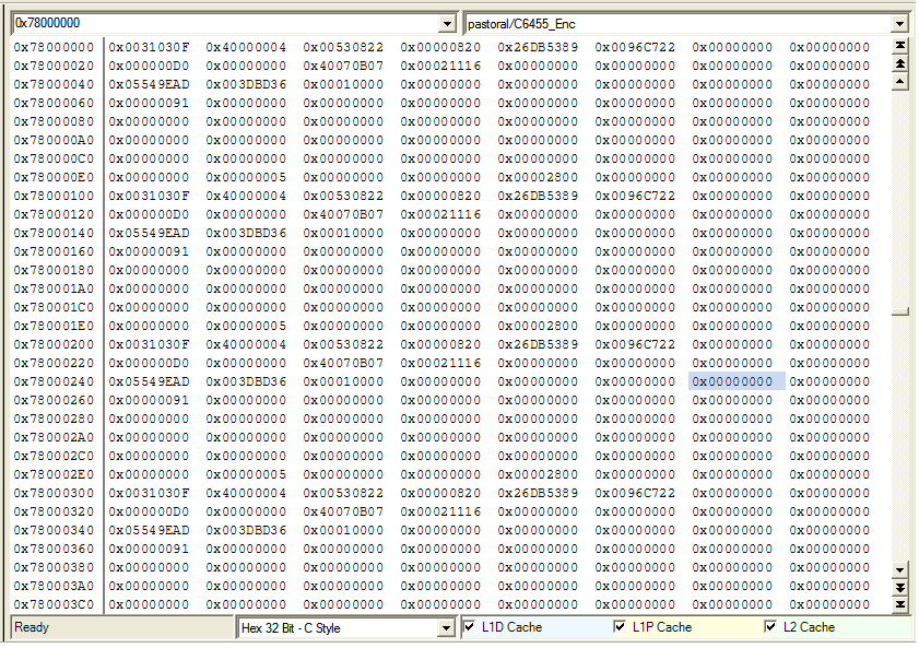

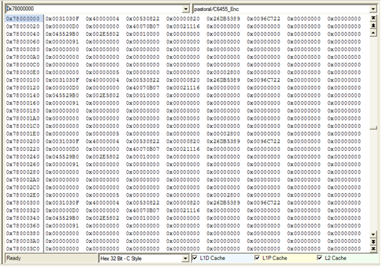

    - Can you provide a trace of the PORz  AND RESETz during the power up sequence along with power rails? (Same as the 2nd trace from your previous post but with RESETz)
    - Can you also provide two sets of dumps of DDR2 registers: One after power up initialization and the second one after the reset that fixes the issue
    - Does a warm reset instead of POR fix the issue as well?
    - Following up on an earlier suggestion by Randy, is it possible for you to pull out the DSPs from the problematic board and swap them with the DSPs on the working boards? It would be good to know if the issue tails the DSP or the boards.
    Also, do let us know the lot trace codes on the devices.
    Do you mind sharing what info are you looking for in the DDR2 registers could be related to the internal memory errors?
    You are loading internal memory test into DDR2. A PORz reset resets the DDR2 and is also fixing the issue until a later power up which brings up the issue again. Ideally we would expect DDR2 controller register reset values to be the same both after power-up and the subsequent PORz.

    Aditya:
    Here are the DDR2 register dump :
    The registers dumps were the same in both the states:
    MIDR    : 0x0031030F
    DMCSTAT : 0x40000004
    SDCFG   : 0x00530822
    SDRFC   : 0x00000820
    SDTIM1  : 0x26DB5389
    SDTIM2  : 0x0096C722
    BPRIO   : 0x000000D0
    DMCCTL  : 0x00000005
    The two screen shots:
    DDR2 Register State1 (With Internal Memory Error)
    DDR2 Register State2 ( No Internal Memory Error)
