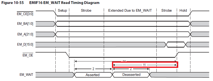

I have a question about EMIF timing of 66AK2H12.
Please refer to the following descriptions on Datasheet.
According to the data sheet of td(EAITH-OEH) max values is defined as 23ns.
We were calculated as follows.
We are setting the SYSCLK1 is 1.2Ghz.
E = 1/(1.2Ghz/6) = 5ns
td(EAITH-OEH) = 4E + 3 = 4*5ns + 3 =23ns
However, We have measured its value was 28ns.
So, We think that specified value of the data sheet is minimum value.
Is My thinking correct?

  • Hi H.U,
    The design documentation definitely shows the 4E+3 as a maximum. The Wait signal is asynchronous and needs to be latched internally. Once it is latched the internal state machine will finish the access by de-asserting the OE and the CE. It appears that the SOC is taking an extra clock in your system. Can you provide a capture of the wait and OE signals measured as close to the SOC as possible? Remember that the rise and fall time of the wait signal may delay the point where it is latched internally. If the transition is slower, the time where the 4E+3 measurement begins may be delayed.
    Regards, Bill

  • Hi H.U,
    I've checked the waveform and I wanted to get an adjustment to the measurement. Clearly the signals were measured at the SOC since the wait signal looks clean and the OE signal has the flat section in the center. The flat section is caused by the reflection of the signal since it is being measured at the source. If you measured the signal at the destination, I would expect the rising edge to be clean but you would have to account for the delay associated with the length of the PCB trace. You placed your measurement point in the center of the flat section but I believe you should be measuring it at the beginning of the flat section. Your alternative is to measure the OE at the destination and calculate the delay through the PCB. If measured at the beginning of the flat section, is the number closer to 24nsec?

  • Hi, Bill
    We were re-measured according to your comments, the number was 25.4ns.
    Why the big delay is observed? Is this affected by the internal latch timing of wait signal?

  • Hi H.U,
    Remember that the returning wait signals is not synchronous to the internal clock used by the EMIF interface. The wait signal must be latched twice to avoid a metastable condition. Once a valid wait has been clocked, the internal state machine must then act on that signal to end the memory access. Unfortunately this delay can't be reduced.
