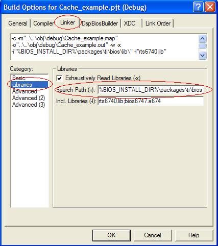

  • This is the DSP/BIOS binary.
    You need to find out where is bios installed in your computer (for example C:\CCStudio_v3.3\bios_5_41_03_17\packages\ti\bios\lib) and:
    1) Set up the BIOS_INSTALL_DIR - environmental variable in windows, se this page for an example.
    2) Or put the path in the linker library include path (Build Options) directly:

              thanks very much.
            I use ccs3.3.49 and SEED-XDS560PLUS. I have change the bios path,now it is working.but the speed is stell so slow. I connet the cs4 to FPGA, and in FPGA I design a sram(or fifo).
           can you help me aggain?
