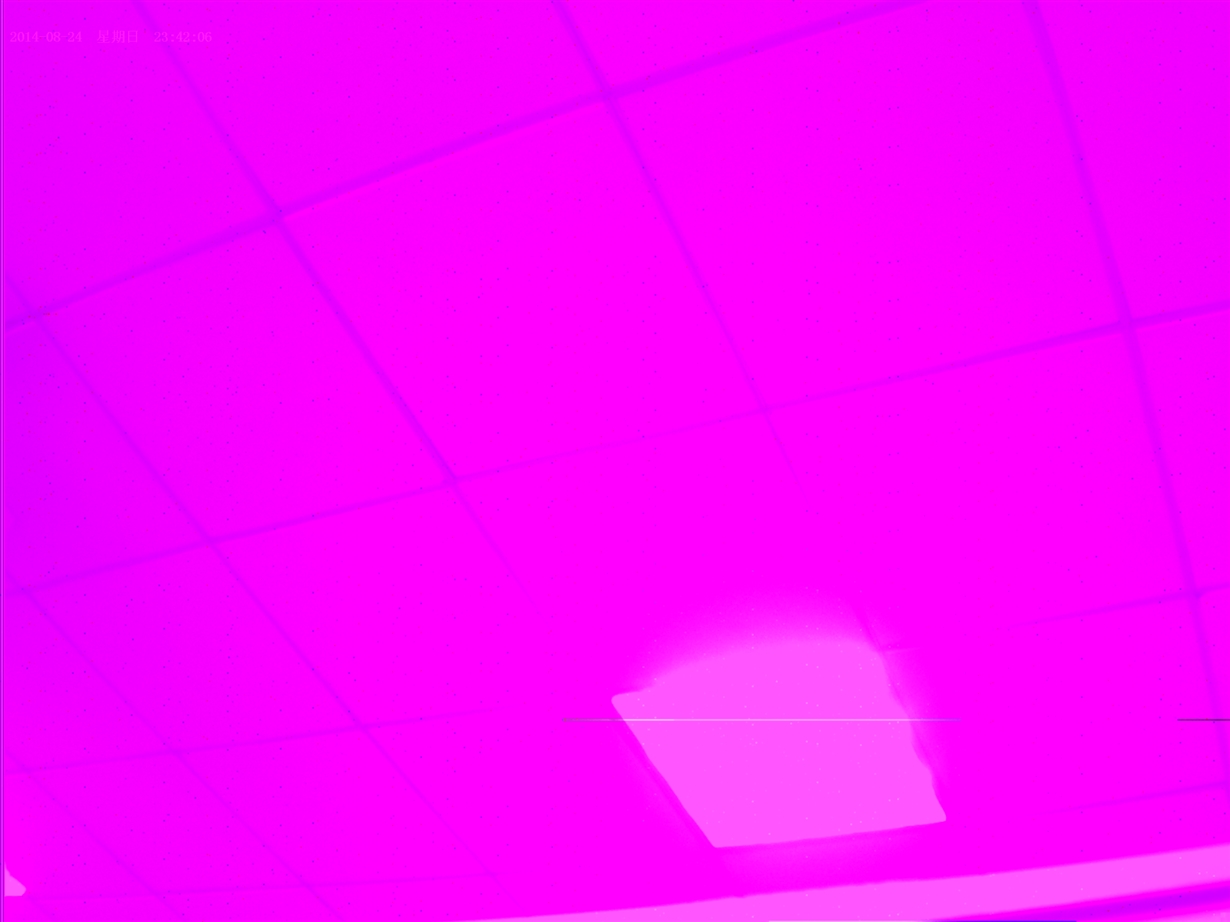

How to tranfer TILER UV data by EDMA in DM8127
There is a problem for transferring  TILER UV data by EDMA in DM8127.
The pitch of  UV data in TLER is 32768, but the pitch for EDMA is -32768~32767, so EDMA transfer UV data first at the bottom line of the frames.
The code is as follows:

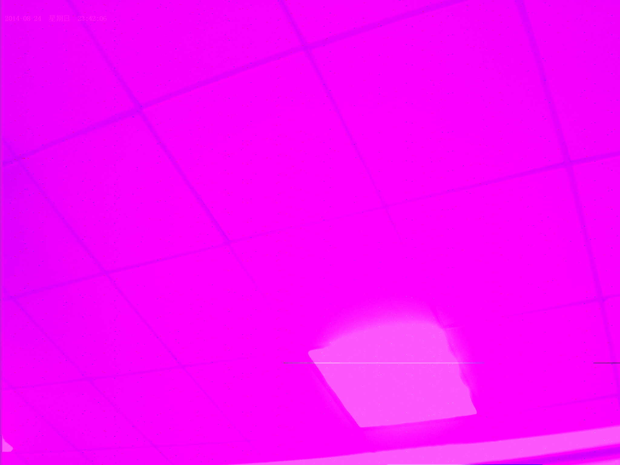

But the image got by the programs is
So what's wrong with the EDMA?
